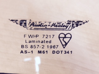

When I purchased my TR-3A (60K+) it came with a wind screen, in a box, and a set of stations. I purchased a TR-3 frame on ebay. After I assembled then, I noticed the glass is marked "Austin Healy". It fits OK, but the rubber seal in off the cowl in some places by 1/4'"
Does anyone else have the same thing?
Here is pic of the of the marking on the windscreen

Thx, Roy

If you put the rubber cowl seal in the groove the wrong way around, it will not fit well against the cowl. The angle of the rubber when installed must be facing toward the rear, which seems counter intuitive, but properly forces the seal against the cowl.
