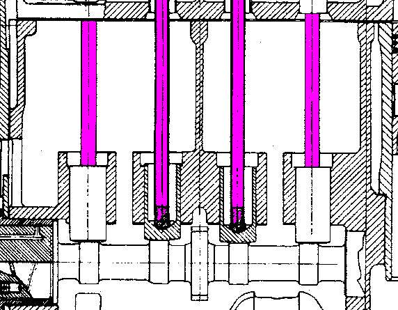

They just sit in their holes, resting on top of the cam lobes. Could be that those two valves are open (meaning the tappet is resting on the tip of the cam lobe), or it may be that you pulled the tappets out of their bores and now they are laying sideways.

PS, this might help illustrate what is in there:

Thanks for the diagrams, it helps explain the system.
