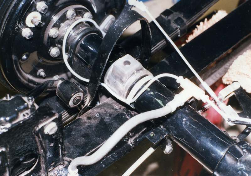

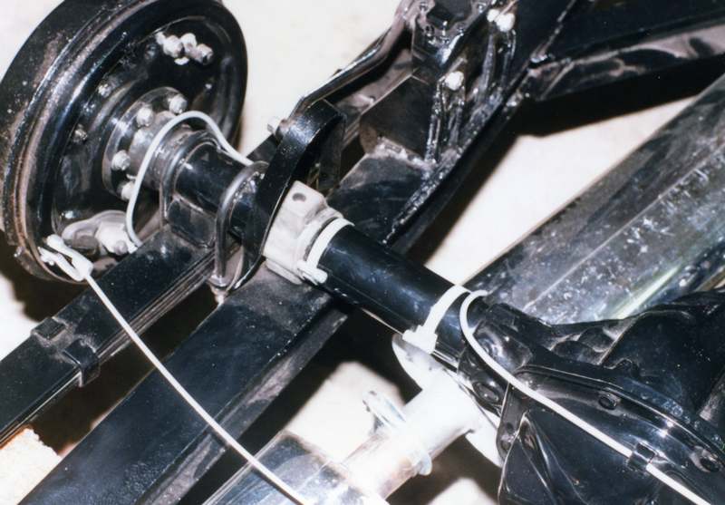

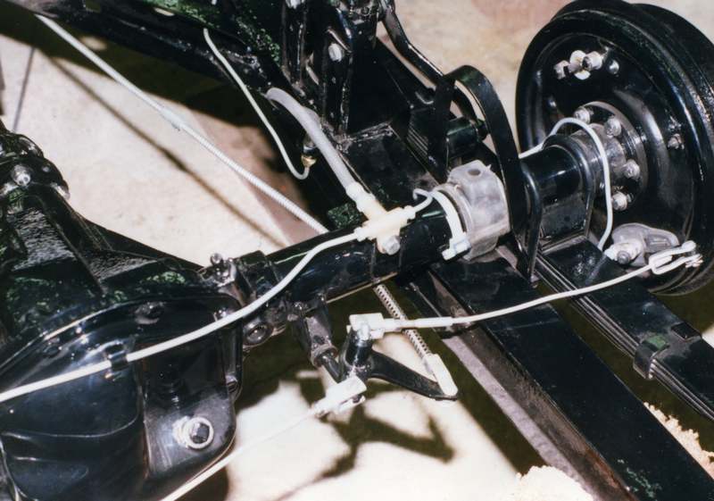

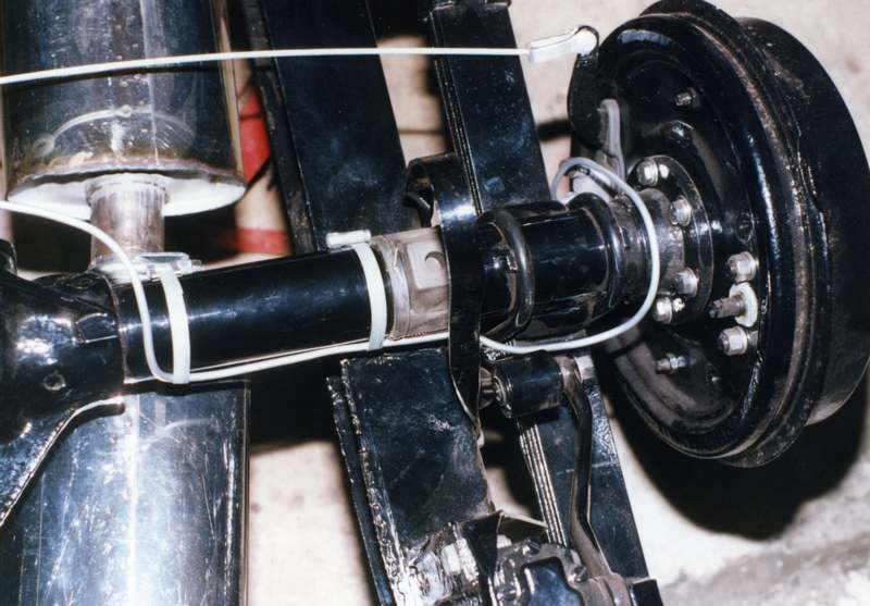

Here are some photos I took when I did mine in 1988.
