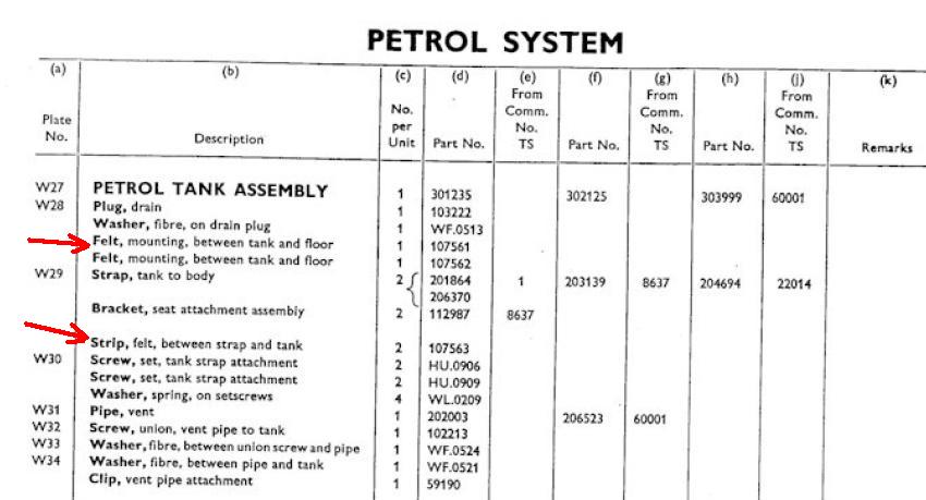

I found 1/4" felt under both of the horizontal bottom surfaces of the tank, where it rests on the body. In tank mounting, there should be no metal-to-metal contact. Felt between the straps and the tank, and felt between the tank and the body. I found 1/8" felt (cheap) at the local surplus guy; doubled it up and cut it to fit. Bonus: it's white -- shows where the fuel is leaking...
I believe there should be felt on the platforms; perhaps you are supposed to cut a piece from the strips you got?
The lowest part of the tank should not touch, so no felt required there.

Tom, listed but not shown in the parts catalog.
