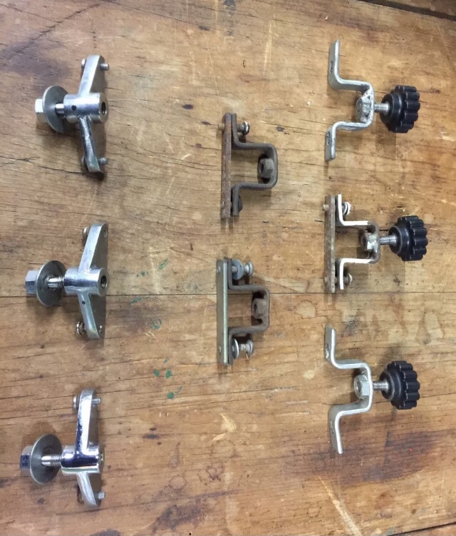

this was mine ( non standard finish)
i had to move my racing roll bar but after that it wasn't toooooooo difficult
as usual lots of measuring and offering up the top for location, slacken off the front screen mountings to help AND fit your side screens as they all come into play at the same time.

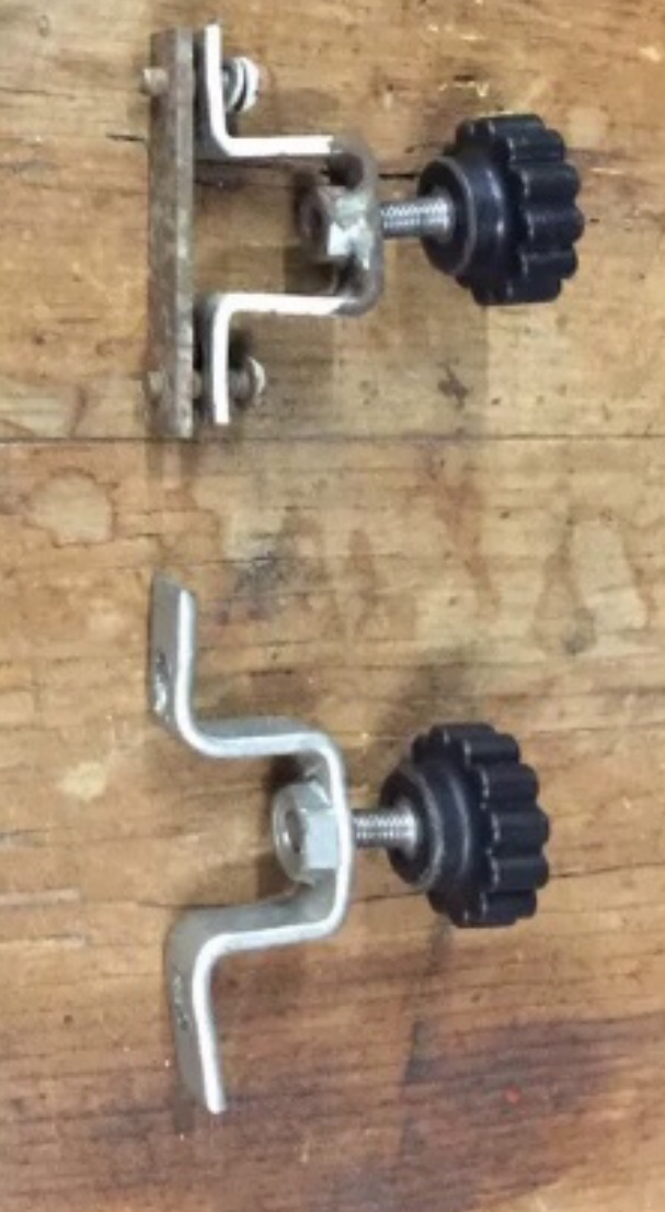

They really aren’t that technical
Bent metal, welded nut and a tapped plate to fix under the car body.
then the capping sits on top ( you drill this - it should be trimmed Ali.
Then you fit the chrome cap covers.
