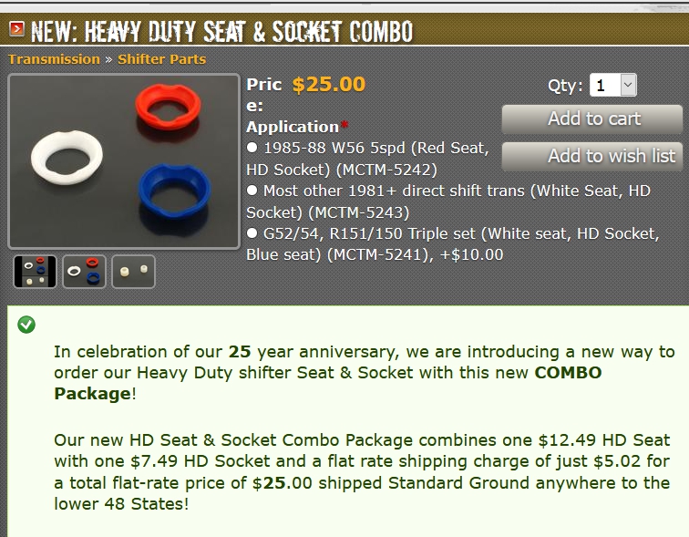

Charlie Hart sent me a link to an improved delrin seat used by the rock crawlers, so hopefully that'll improve things.
I purchased the white heavy duty seat & socket combo from Martin Crawler. Gives more precise shifting than the softer Toyota seat.
