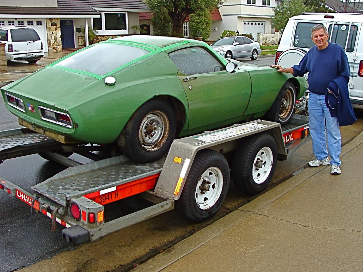

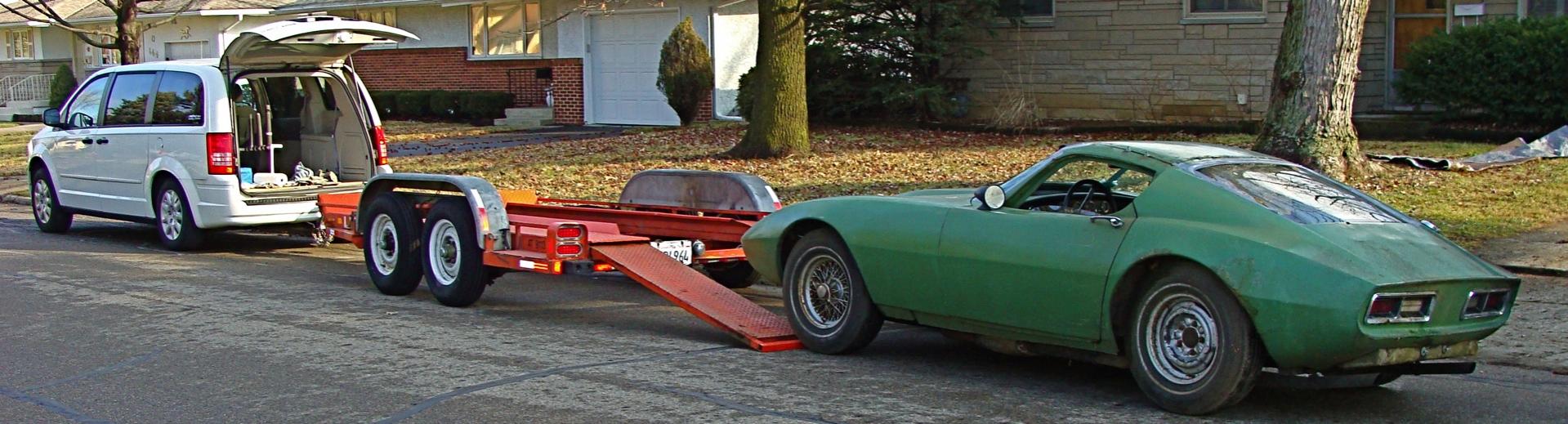

I used an U-Haul trailer to tow mine from Columbus to St. Louis and later St. Louis to Los Angeles. No sweat.
Chris...
