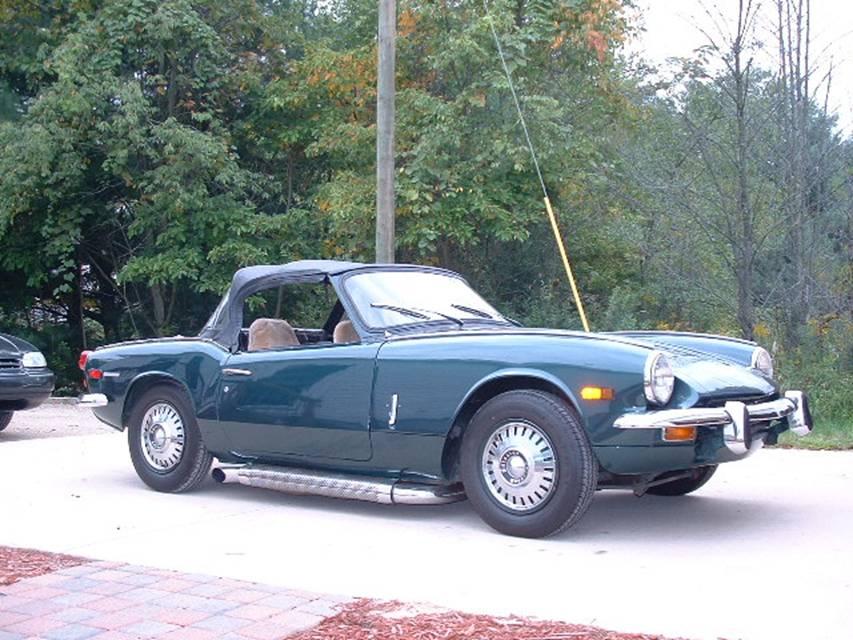

How about some pics of the Spit?

The ramps come close, but don't hit the Spitfire.
What do '70 wheel covers look like?
