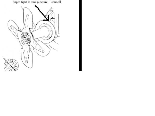

Except the a stock TR2-4 engine doesn't have any kind of damper on the crank pulley. And the pulley is drilled with a mark for TDC, and while it can be installed off (there are six bolts in the pulley that mate to the hub, and the hub can only go on one way), it should be easy to tell if it is right.

You are not talking about the hole in the fan pulley and pointer on the timing cover, are you?
Ed, Poolboy and Skinned Knuckles have TR6s, which have harmonic dampers, while TR3s just hane a hole drilled in the pulley. I guess they thought that the TR3 has dampers like their cars. That's why the TR3 manual does not mention a damper.

Yes, the TR2-4 engines have a small hole drilled in the back half of the crank pulley, that (if the pulley is properly installed) will line up with the pointer on the timing cover to indicate TDC.
There isn't any scale, so to use a timing light, you need an "advance" timing light.
