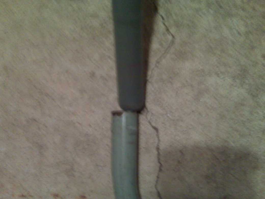

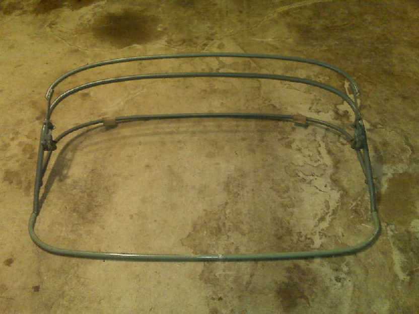

If the bar I have is not correct for a BT7, can someone tell me what car this bar would go with? It's just a tiny bit longer than my top bows (see pictures below - when placed with the bottom of the rails aligned on the right side the other end is about a quarter "circle" longer).
You may barely be able to see the overhang on the left(close up added in next post). Also, the tonneau bar feels like the circumference may be a tiny, tiny bit larger than that of the bars on the top bow. Another important note is it has solid caps on the bottom of the bar ends.

Here's a close up of the "overhang." Again, the tonneau bar seems a bit too long and has solid caps on the bottom of the rails. Doesn't seem damaged in any way. Could stand a re-paint maybe, but seems correct otherwise.

The tonneau bar goes into the same holes as the metal frame for the soft top. If they are a little bit off its just because the tonneau bar is bent a little (or the car is bent a little). The tonneau bar on mine goes in easier than it comes out because once it's in its in under some compression of the bar. If I am not careful removing it what will happen is it will spring up a bit, on one side (the side I am not on), and perhaps scratch the paint. That may be why your tonneau bar and soft top frame aren't alligning perfectly. No biggie though!

The tonneau bar is quite longer than the soft top frame and is using the same hole. It“s longer to give tension to the tonneau.
The bar originally is one piece, but I have the two pieces because is better to let with the tonneau into the trunk.
