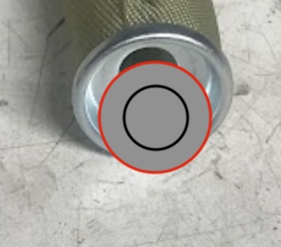

I bought a new sock filter for the gas tank from Amazon as they are unobtanium elsewhere. If you look at the pic it is fairly obvious that the hole is too big for the pipe. I am looking for suggestions as to how to connect them.
1) I do have a rubber grommet that will work - it will fit in the hole (slot) and fit on the pipe - my fear is that it will perish in the tank.
2) I could wrap it with metal and solder it all together - it would be messy but it would work.
any other ideas?

How about taking a piece of thin sheet metal to fit the approximate inside diameter of the large fitting and either drill or punch the correct diameter for the pipe. After making sure things fit, then epoxy the sheet metal onto the sock filter..... Just a thought.
Great idea - we are also talking about JB weld.
The one in the Ranger has a soft plastic ?? sleeve for the pipe to slide into, it is tapered so it's easy to slip on the pipe but hard to pull off. If you go on the net and type gas tank sock filter, some should pop up with photos and you should see one with the plastic "gripper-seal" I'm talking about. PJ
