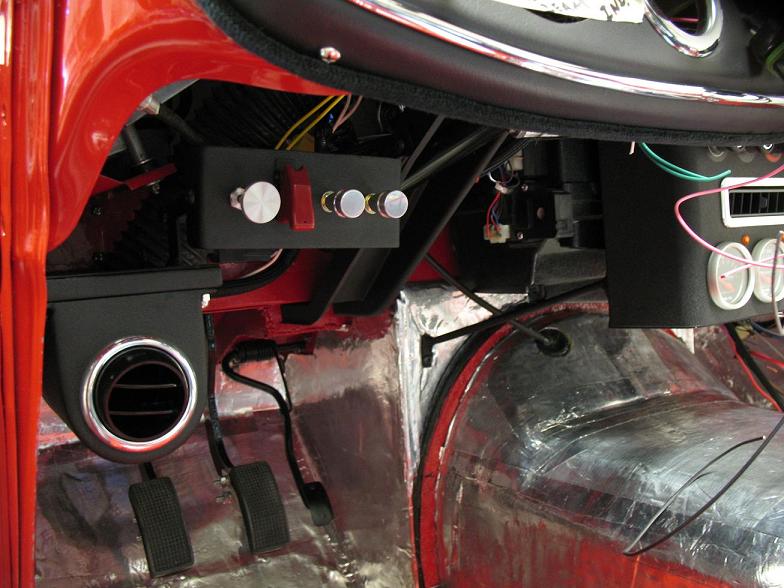

I didn't jump in before since I didn't have any pics of my switch bracket.... but I reinstalled it yesterday. It is powder coated in black wrinkle finish which has a look much like the BMC things that were added it in the day. Now if I can figure out how to add the pic.... You can also see my A/C drivers side duct.

Hey Steve,
Wow, do I see a lot of things wrong!!!
As in it's just wrong that some of you guys are doing such an outstanding job. Man that is one sweet bracket.
Got Hot feet? Not me mister. Look at all the heat shielding.
I could go on and on about how many upgrades I see you have done, (AC, heater, knobs, safety toggle) but it would humble my attempts at what I've done. (Hey guys, look what I've come up with...fuzzy dice hanging from the mirror. I know, sweeeet!)

Thanks Roger....I think ;-). Actually, those knobs are from right to left... dimmer for aux. center console led's, dimmer for center console instruments, hazard light switch, and fresh air pull (I modified the fresh air box to feed both the drivers side and passenger side (I cut out the partition inside the box)). The A/C controls are on top of the center console. I'll include a pic of that since I now know how to do it. The insulation is double layered on all engine facing surfaces (doubling this insulation triples it's insulating rating).

Nice work Steve. The next tip for you shall be editing posts (since you've gotten adding pictures down). At the bottom of a post you made, you'll see a "edit" button. You have a couple months I think to change stuff. :thumbsup:

Is the gearlever the stock length?, and did you put the insulation on the inside of the tranny cover to reflect the heat also?

Bundyrum/Lin, I didn't really mean to sidetrack the topic, I was just trying to clarify for Roger the knobs and such.
Anyway, insulation on inside of tunnel... I put aluminum panels spaced 1/4" off the tunnel to direct the hot air away from the tunnel...with the double layered top insulation it is hasn't shown any heat during dyno tuning. The gear shift lever is shortened...and, although it is an AH lever, it connects to a Toy 5 spd.
