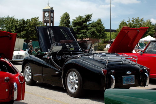

Or alloy knockoffs. These directly interchange with wires.

[ QUOTE ]
[/ QUOTE ]
JFS,
Is that your TR? I like the hood louvers. That pic must have been taken in Rockford, IL...I recognize the "Clock Tower" in the background...
YankeeTR,
Yep, that's my TR. I had the louvers punched in about 15 or so years ago by a local hot rodder to help cool it. Are you a member of VTOW?
[ QUOTE ]
YankeeTR,
[/ QUOTE ]
Not a member...I probably would have joined but, after looking a their website and seeing how out of date it is, I figured it wasn't a very active group.

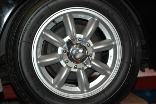

Here's a better pic of the knock off alloys.
