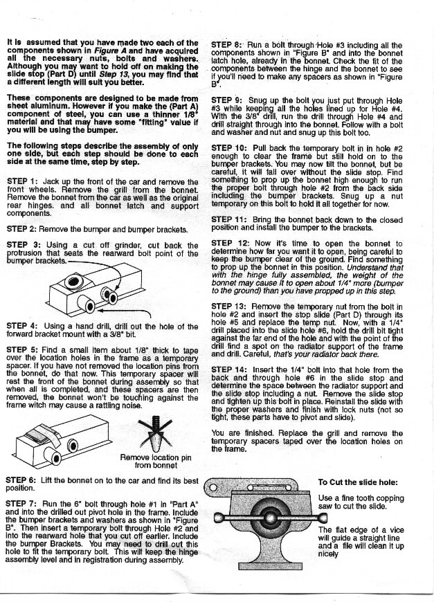

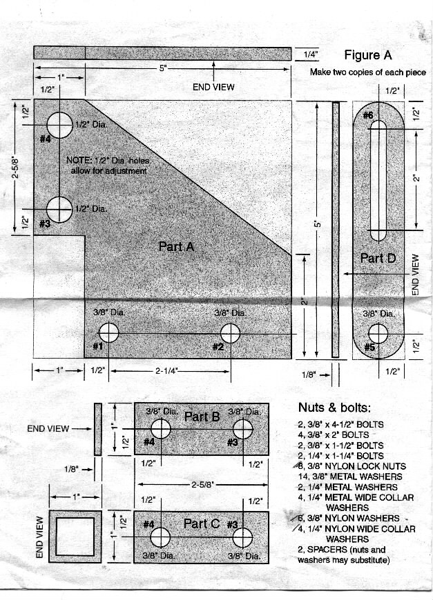

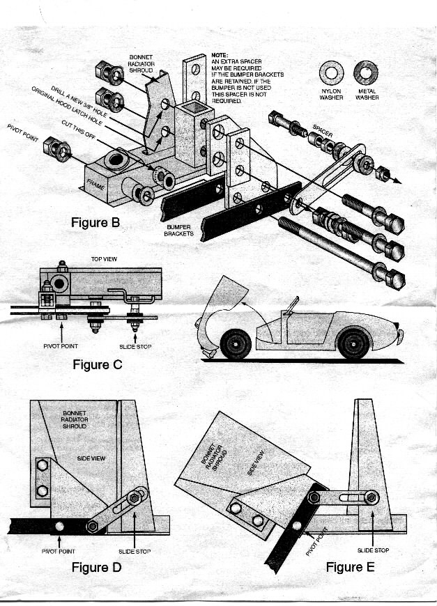

You can make your own out of aluminum plate if you are good with a hacksaw, drill, and file. And yes you can retain the bumper.
Here is the basic drawing... somewhere I have the instruction sheet too.
Here we go...
