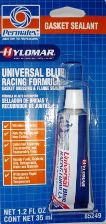

Here is all you need to know...

And +1 on Hylomar. Hylomar really does remain soft forever (well, at least for 10 years which is about how long I've been using it) and seals just as well as the others.

I'm with Walter. First of all Hylomar is not RTV silicon. It is a permanently elastic compound that has high adhesion and permanently seals parts even under high vibration. Developed by Rolls Roice and will fill gaps to 0.15 mm. Any extra that could ooze out will not harden and fall off. I have seen that with RTV and it was stuck on the pick up screen for the oil pump.
I use it a lot. In fact may years ago I had to replace the oil pan gasket in my wifes 240 Volvo and used it on it. Years after that I had to replace the oil pump seals and the last bolt I took off the pan and it just fell off. Never a leak and the pan comes off that easy. Also the gasket just pealed right off. Amazing stuff. Also no down time because you can put into service immediately. The lack of oxygen cures it.
Do your best too to straighten the pan first if it is distorted. Clean and polish all mating surfaces. Then apply.
:iagree:
But "Blue Permatex" might be
