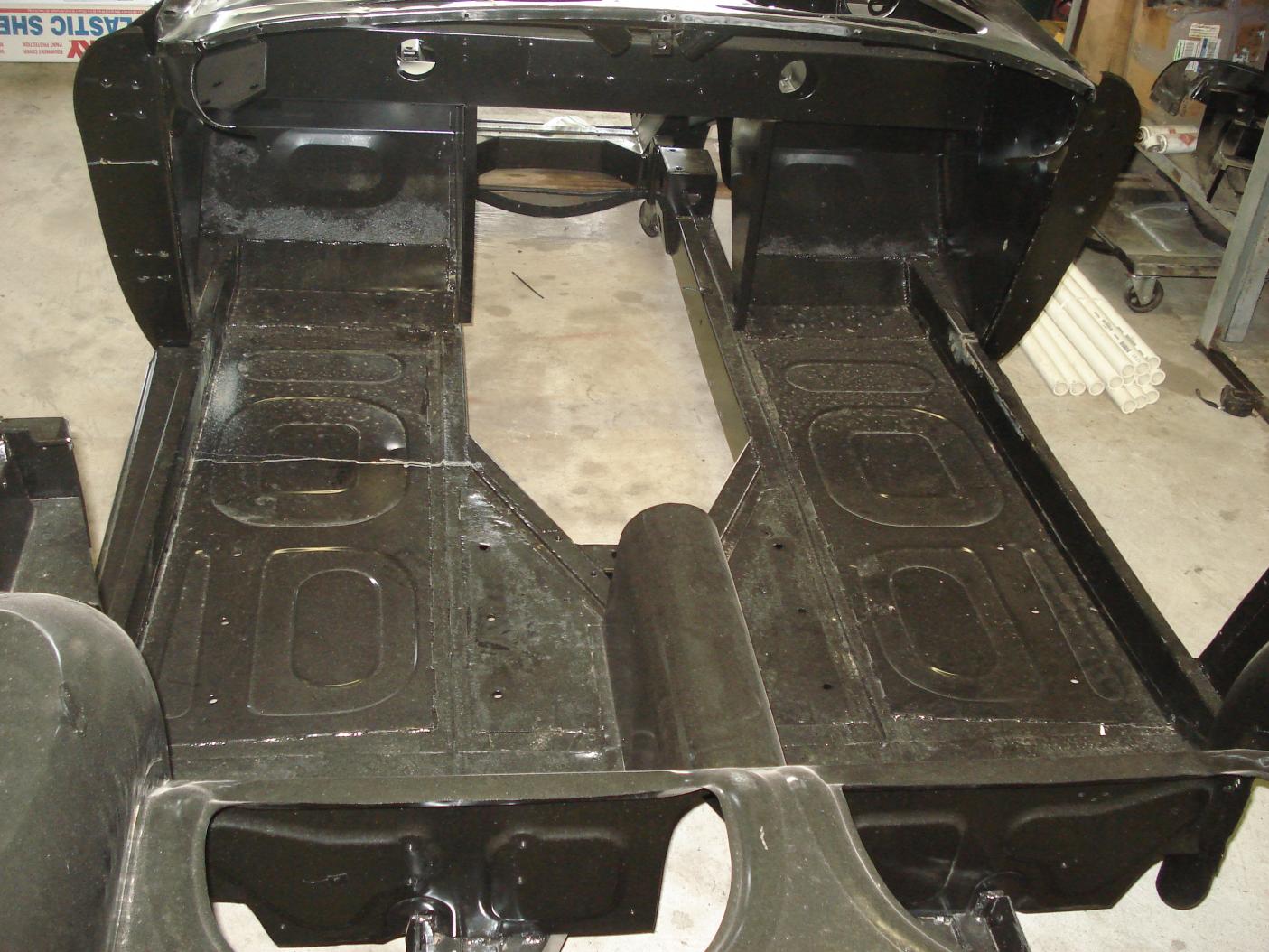

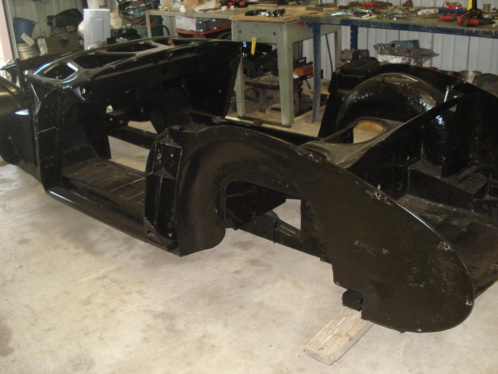

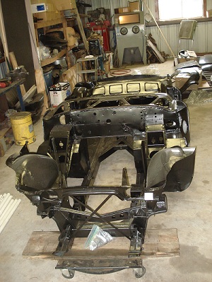

I had my chassis dipped and E-coated. For the most part I was satisfied. However, ther was some stuff that ran out of some holes in the frame and left a little corrosion. If I were doing it over I would do as much of the welding and pannel replacement as possible before dipping so the the new stuff could be E-coated. Of course there will be some damaged places that will not be obvious until after dipping and must be dealt with.
