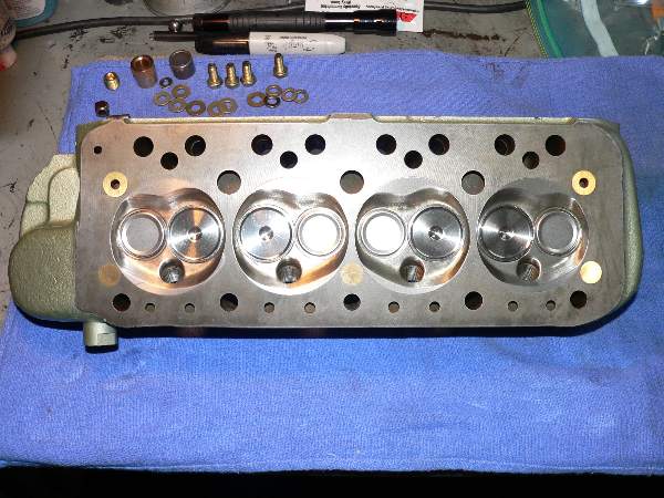

Here is the finished head's combustion end.
All shiny and purdy.

Yep, this mod was not by desgin, the angle cuts around the combustion chamber were to buy him more CC volume in his head to get his compression ratio back down. Now mind you, I'm not picking on our buddy, all of us have gotten ourselves in "tail chasing" situactions before, myself included. Here's the biggest piece of advice I could give any of you playing with short deck height and head decking to this point to raise compression ratio, measure, remeasure, remeasure again, then measure another time to be darn sure. Also what I do on my perofrmance build is complete the cylinder head, just less of fully assembling, than after I've got my block done, and my deck height confirmed, then and only then do I fiquire out how much to deck off the head.
Our buddy got into trouble doing a zero deck block by not measuring at the piston pin axis, that is the only place you can trust, anywhere else would have piston rock and askew your measurments. I don't suggest a zero deck height for almost all engines, if for no other reason the few thousands of inch difference in rod and piston length, then piston top machining will be the only course of action to correct, and if you have dish piston, this may mean even more piston machining to get the dish CC back, I don't even do zero deck on most of the race engines anymore , becsuse it will lead to alot of unecessary extra machining, shooting for a .005" deck height is much safer route, and you can still get to your target CR with head decking.
These days I spend more time fiquiring out how to get to the results I want by the most simple means I can do it. I've been exaclty where our buddy had with this engine and I'm sure he would approach this differently if he does it again. He's built several engines in his life, and this one was probably the most advanced one, and we learn from our experiences, every hurdle had been over come with extra machine work, and this is going to be one trick engine
that should work well, but this is not lesson in what to do, but more how to overcome whan things goes wrong. He's not alone any of us that have pushed the limits have been there, I recnetly had a machinist screw up the decking of a MGB race block and had to a buttload of piston maching to overcome it, and even thought this time it was the machinist fault, it has been my fault before as well. Our buddy did a good job of finally catching his tail and now is a member of the club :smile:
