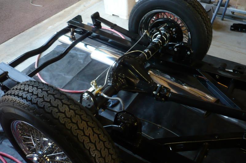

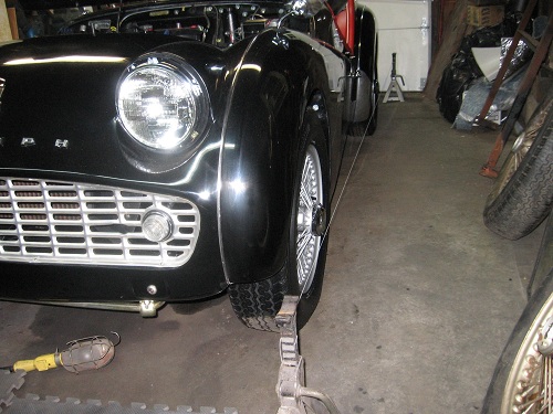

I've got Vred Sprint Classics on my TR3, but they are on wider (5.5") wires. I'm using 185-70/15. Nice tire, handles well. I aligned using the string method.
