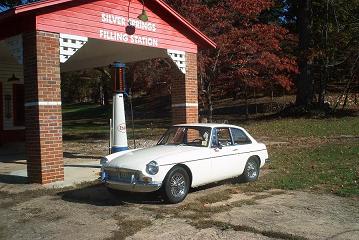

In my Goodyear dealership days, we used to do alot of tube tires, we would rub the tubes down with baby powder, makes them less likely to shafe against the inside of the tire. The spokes wheels on my 67 GT are the Dayton chrome tubless, nice wheels if you can budget for them, makes living with spokes alot easier. I'm running 5.5" wide Daytons and running 195/65/14 Michelins MX4s, they've been great tires.
