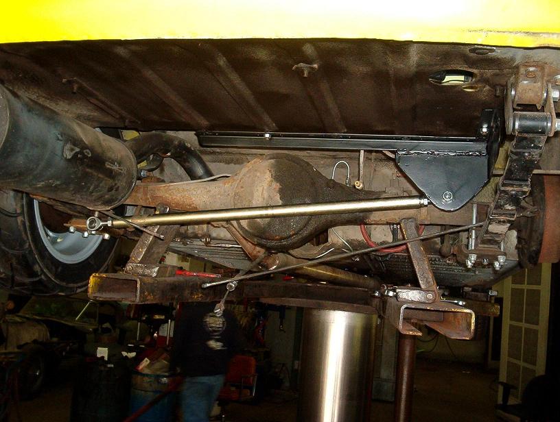

Depending on where that one attaches, it looks like it'd be great. Mine's a little rougher, but it works. However, I'd like to see that one in place. I'll put up some pictures of mine, along with some more comments later.

Here is one picture of my installation of the panhard bar. If you have any further questions, just post'em! This shows the bar before the gas-tank is re-installed. The bar wraps around the tank and uses the existing mounting studs, as well as some additional ones drilled through the floor to supplement.
