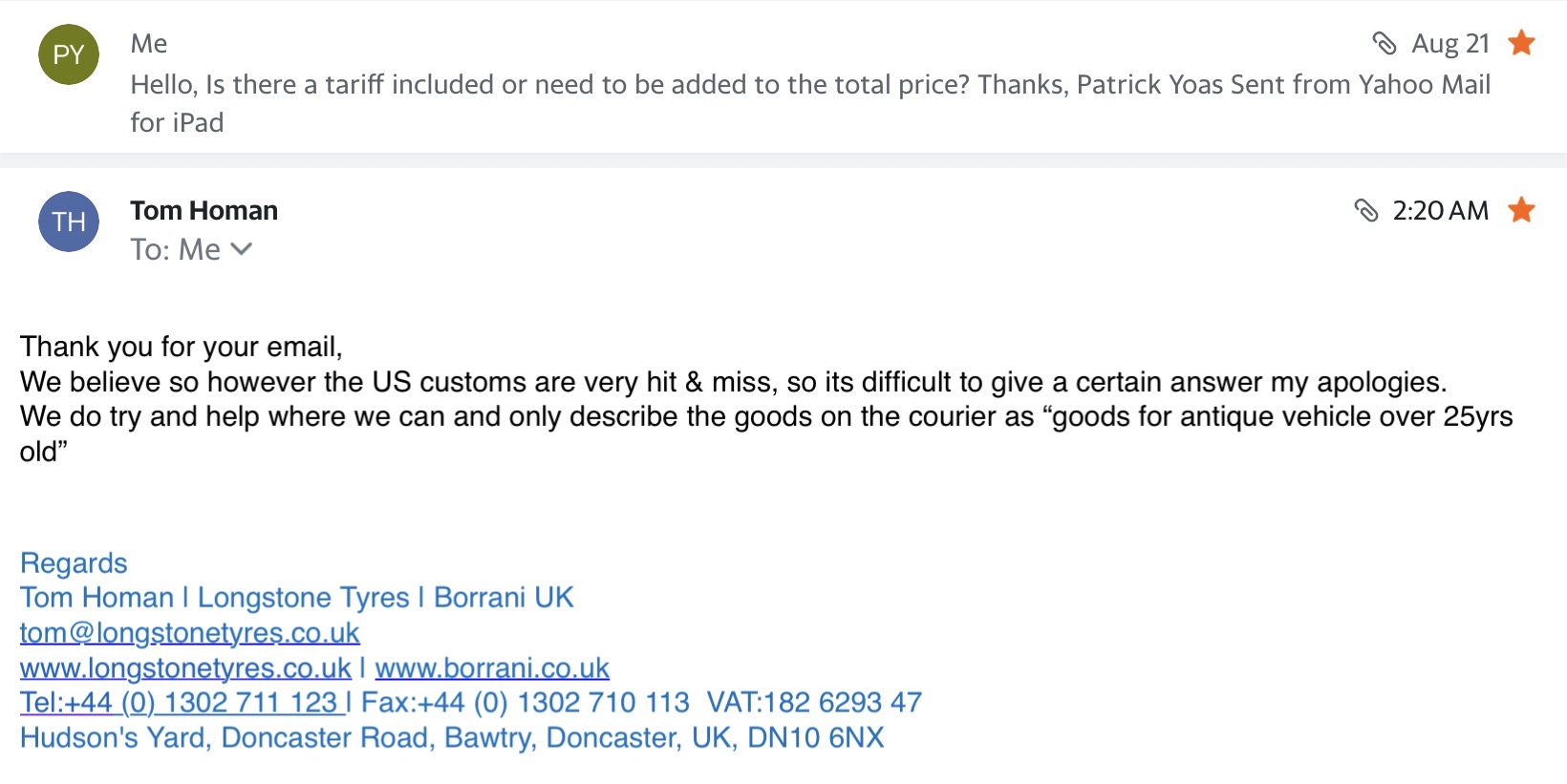

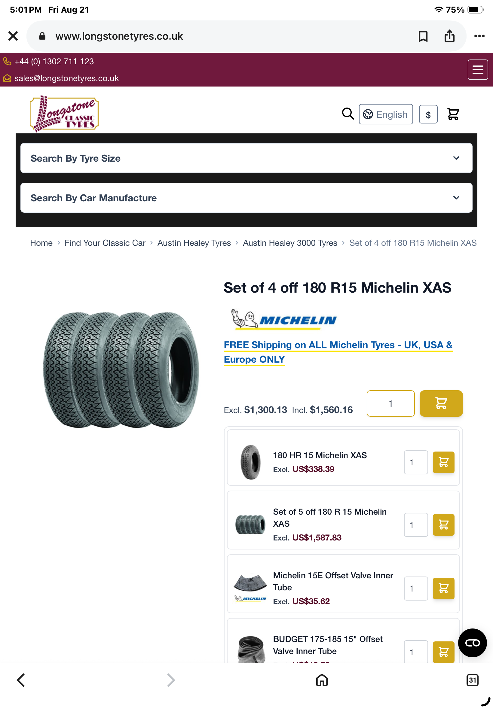

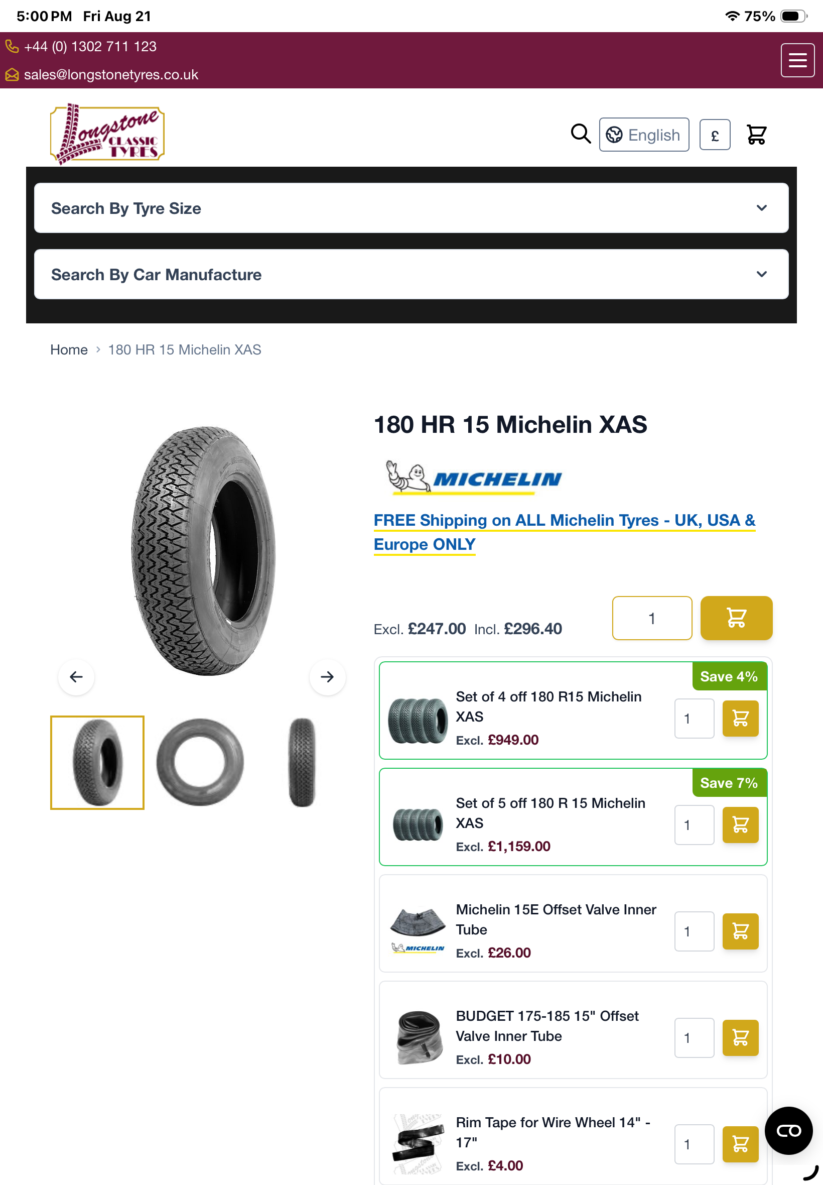

This is the price off of their website. I asked them if any tafiffs. Were included.

Here is what I found out about the tariffs we can expect it not expect right now.

I recently, as in last month, purchased parts from a supplier in England. The import duties/tariffs were ~30% (ouch). I double checked and this is the correct amount based on current policies. They didn't make me aware of this before or when I ordered. The parts were here in the US setting in customs when I got a whopper of a bill from UPS. Beware...
I have the Michelin XAS 180 HR 15s on 72 spoke Daytons on my BJ7 Nasty Boy. I've used XAS tires on bugeyes, Fiat 124 spiders and X 1/9s. Absolutely love them. I too, purchased from Longstone and drop-shipped to Alan Hendriv for mounting, shaving and balancing. Whole thing was seamless. Unfortunately, I think the tariff situation is going to make buying from Longstone more expensive. Not only the tariff, but shippers have been adding additional fees for customs brokerage, etc. And as Wally says, you don't know how much until you get the final bill. I just saw that Tire Rack is selling them now, which may be more reasonable. > Tire Rack <

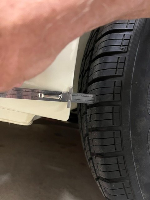

I currently have Nexen165/80R15 tires installed on my BT7 and am very interested in using the Michelin XAS 180HR15 tires. Does anyone have a measurement for their rear wheel to fender clearance with the Michelin XAS tires? I have about 1 3/16" clearance with my Nexen tires. It looks like this would reduce to ~ 1/2" with the Michelin XAS tires. The extra ground clearance would be a plus, along with the look and gearing.
