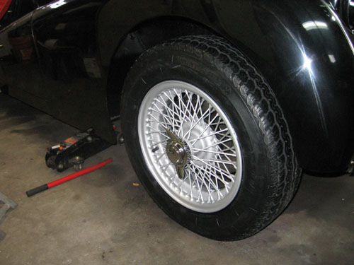

This is a pic of the Vred Sprint + on my wires just in case you wondered what they look like.
