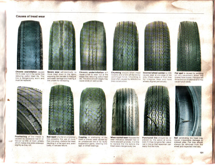

Maybe this will help?!...According to the attached, wear on one edge would be due to incorrect wheel camber - both edges is under-inflation. Toe-in or toe-out would cause "feathering"
