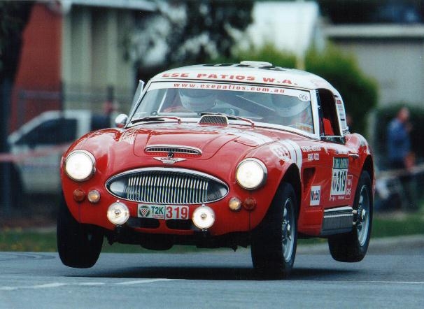

Course workers would tell me that I'd pick up an inside front wheel in big steady-state sweepers with my Healey (and similarly, with the M Rdstr too). It didn't really carry the wheel, as described to me, it was more of a touch, skip/glide, touch scenario.
Still though, getting daylight under a Healey's front tire is pretty impressive ;)
Keoke
Close--LOL
Keoke
Reset the game clock picture out for review-Keoke--LOL
OR he probably got balloon tyres
