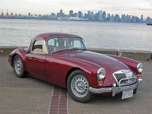

I am currently using 5.5" rims with 195x60-15 AVS ES-100 Yokos with a nice sticky compound. Pictures of the MGA (sorry, no TR-3s currently in the fleet) are with original size Michelin 165 ZX on 4.5" rims and the Yokos on the 5.5" tires. Which do you think are more fun. And I laugh at people that complain that modern sticky tires won't last as long. With the amount of miles most hobbyists manage to put on their vintage cars, any new set of tires runs a good chance of lasting far longer than the recommended tire life.

I totally agree. BTW, nice-looking MGA! Especially the knockoff wheels.
Bill, that bottom pic is doctored. No way was there ever a day like that at VanDusen
