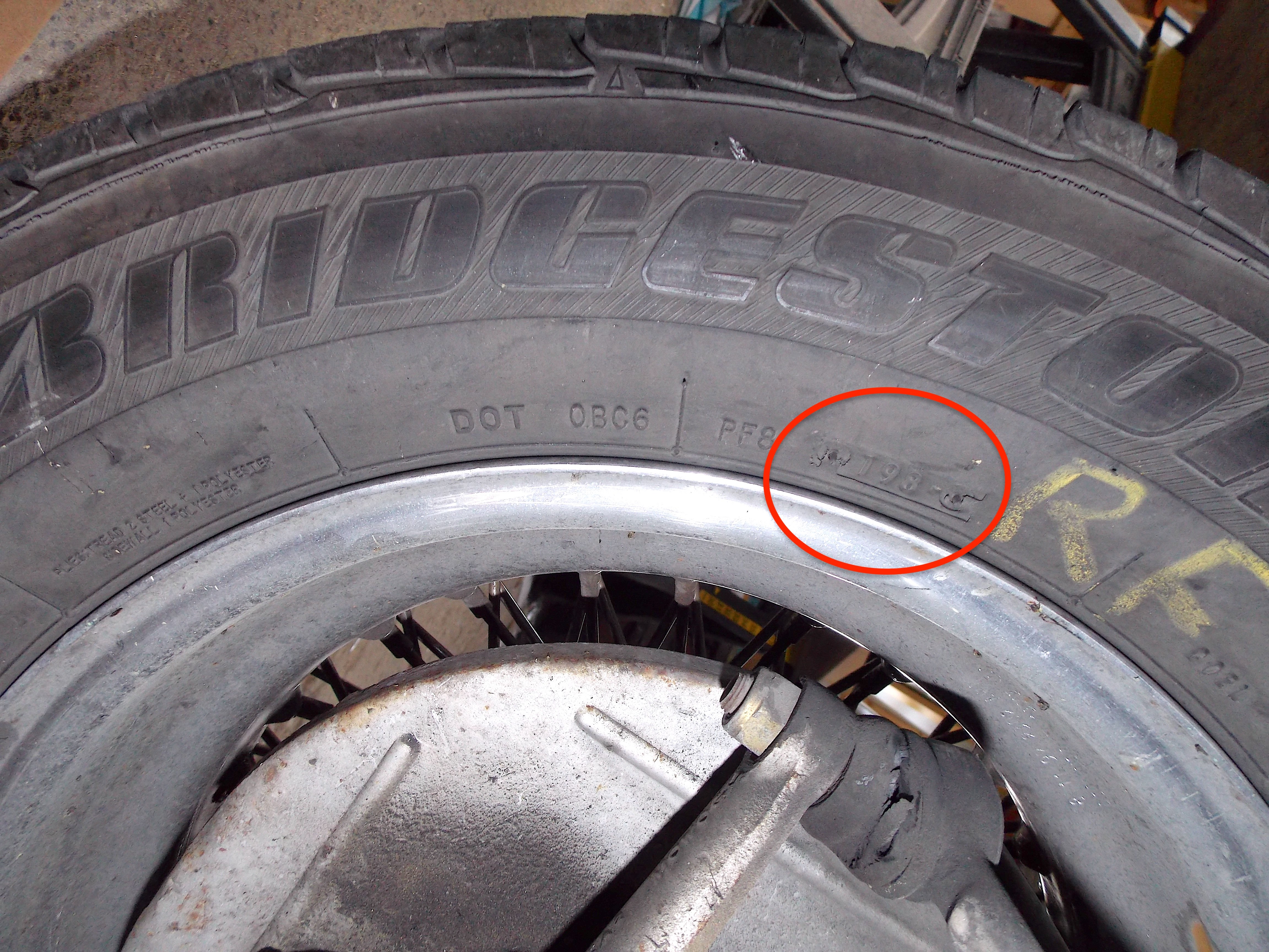

You can find out how old your tires are by looking on the backside of every tire for the DOT number.
In my case the "198" means they were made in January of 1998.
These have since been replaced, they had plenty of good tread but were very hard and slippery (see photo).
I wanted to send them away to get trued, shaved and balanced but the guy said he wouldn't do it because they were 10 years old.
He told me I better hope the Lord isn't mad at me...so I bought new ones.
A word to the wise was all it took.

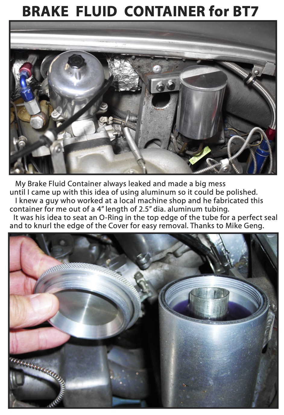

Have you considered Silicone Brake Fluid... it doesn't absorb moisture ?
I had my calipers sleeved in stainless steel by the Stainless Steel Brake Company 30 years ago.
They recommended the Silicone Fluid at the time so I followed their lead and I'm glad I did.
In all that time I have never had a hydraulic fluid leak and never had to fill the Brake Fluid Reservoir (which I converted to aluminum).
And my Brake Pedal continues to be firm year after year with no brake fade what so ever...Go figure.
