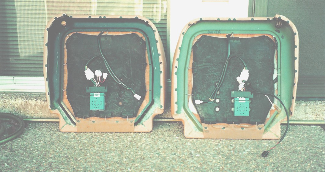

well Basil, you paint it in Primer, that's how they came originally, a sort of a celery-green color primer used at Jaguar all the way to 1989 when Ford introduced Black to the British. My 1965's tanks are celery green, and my 1984's tanks are celery green. Even the body's primer was celery green. I have a video showing the manufacture of Jaguars at the factory, and they were primed in celery green before entering the spray booth.
And for heaven's sake, it's only a gas tank, you don't have to paint it like Michelangelo. If you saw how my 1965 and 1984 Jaguar gas tanks came "painted" from the factory, you'd probably do better than the factory with a cheap spray can!! (assuming you can get the celery green).
By the way, the same green was used on the seat frames, here's a picture showing the underside of my XJ seats in (you guessed it) Celery Green.
