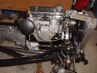

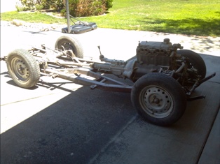

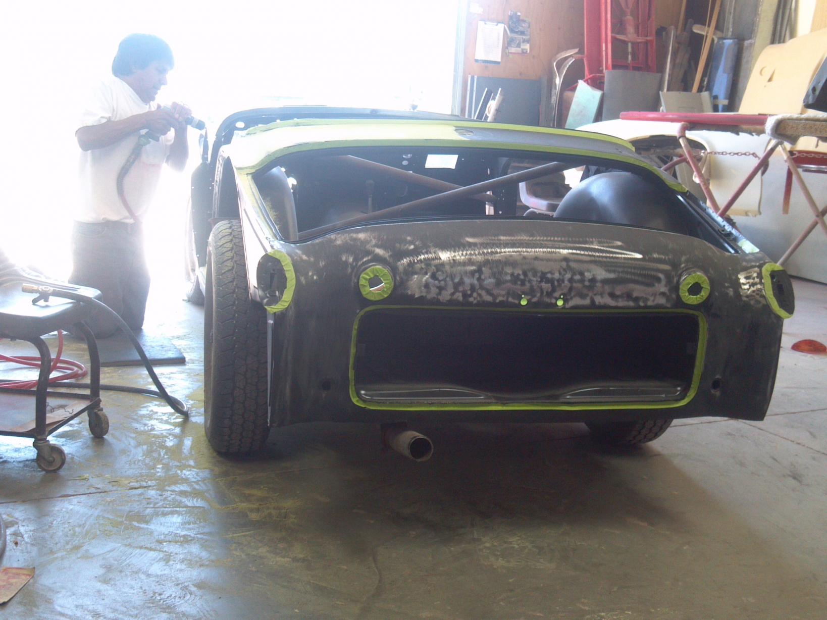

This is like a party! I am just about at the same point as all you guys! Whoo hooo! I have to fine tune some stuff but I will be having the body painted by the start of September and then "putin the buggar" onto the frame! here are some pics; Chassie one year ago (Aug 2012), now (Aug 2013) and body work prep (July 2012)! This is so great! Cheers to all!
Engine & chassis  full view Aug 1 2012 email large.jpgEngine on chassis (1) Aug 1 2013 email lg.JPGBody Work May 31 2012.jpg
