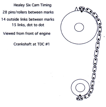

Scuse me for confusing things. I think the problem is in the definition of links. Two of the 15 links "dot to dot" are actually half links, if you consider that a "link" has two pins/rollers.
I think the attached pic shows the story. OK Keoke? The pic may not be oriented exactly correct but the "link/pin" count is correct.

Yep, that is a good piccy for them to follow. /bcforum/images/%%GRAEMLIN_URL%%/thankyousign.gif---Keoke
Set 13 outside links between the Dots = 26 Pin/Rollers.
