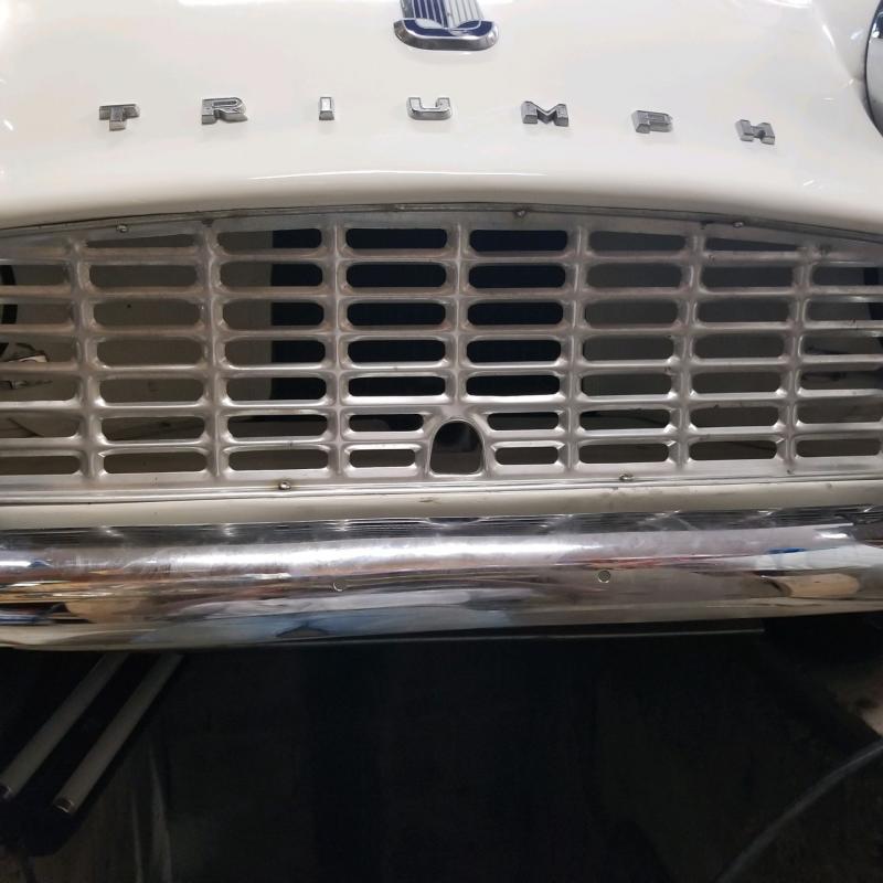

I did open up the front grill a bit as I had read that the opening size had been reduced on later grills and people had found that a problem. It seemed to give me about a 5 degree reduction in temperature.
The grill openings around the crank hole are the original size.

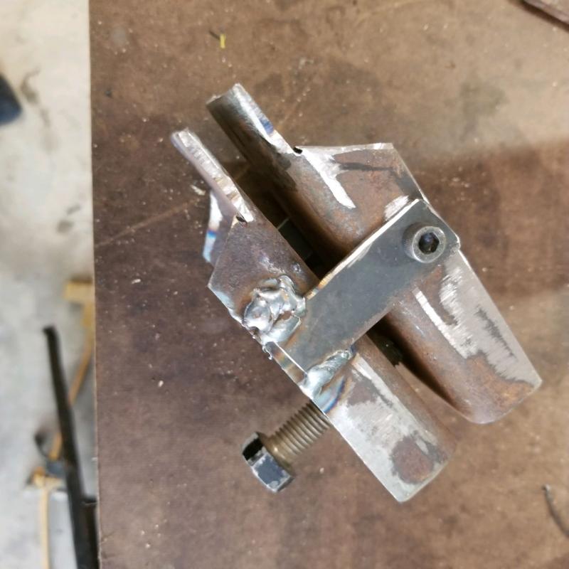

The tool I used.
