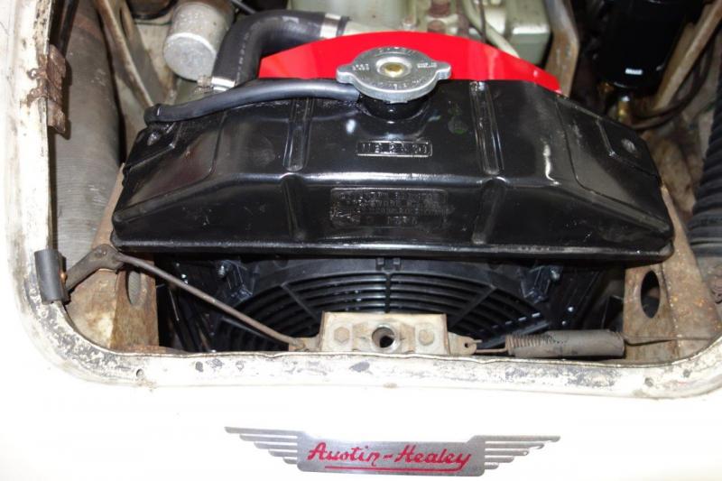

I installed my pusher fan on brackets fixed to the upper and lower rad side mounts. The fan sits about 1/4 inch from the front surface of the rad core. This hasn't been any problem.

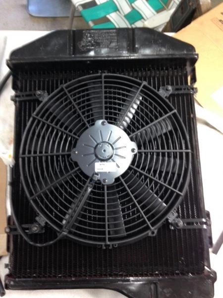

For my pusher fan install, the radiator repair guy I use soldered 4 studs to the radiator frame. I used SPAL fan mounting brackets (cut shorter and bent). The fan is ~ 1/4" off the radiator core and just fits in front of the X brace. The fan is controlled by a Derale fan controller which allows the fan to be off (controller disabled), on/off determined by radiator core temperature sensor or manually controlled on/off (controller enabled). I have a LED light located by my toggle switches which lights whenever the fan is on. That way I know if it is on when driving at speed. I located the fan controller high on the passenger side inner fender. SPAL also sells a wire connector pig tail which didn't come with my fan which simplified the wiring.
I kept my original 4 blade fan. For a low tech air flow test, with the hood down, engine idling and fan off, I placed a shop towel on the grill....it just falls to the floor. With the fan on, the towel was held firmly to the grill.
I am pretty happy with this solution. It doesn't seem to impact the operating temperature much (if at all) when the car is moving. It definitely helps when stuck in traffic and when I back the Healey down the long driveway to my shop.
Here's a couple of photos of the install.
I have also fabricated a "bottom" to the radiator air deflectors just to see if it will help with directing air flow to the radiator, but I have not installed it yet.
