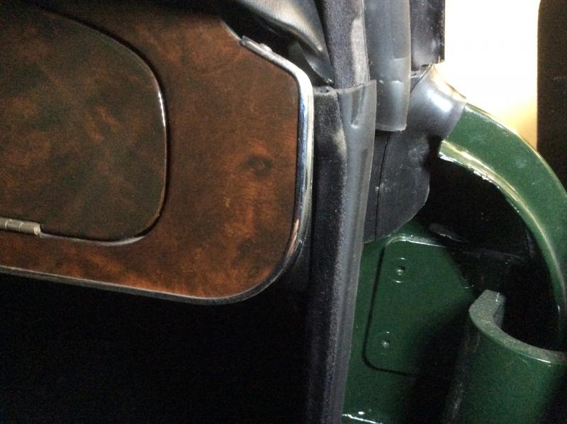

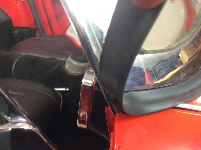

The long extra section of the seal as shown in Healey Nut's photos is held in place by the windshield post push-on seal, which should continue onto the flange of the front fender, instead of being cut as shown. I will look for a photo.
Bob
Nope :nonono: Healeynut is correct !
Yes please post a photo B_R! Is there an extra part involved? Having trouble visualizing this.
Here's a photo from the Anderson-Moment book. It has also been posted earlier by Dave Russell ( 11-14-2012 ) in a thread about Bristleflex on a front pillar, to get a clearer picture.
