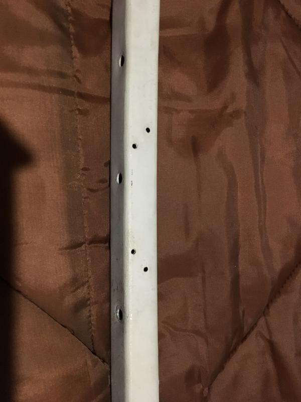

on the bottom side of the tie member there are 4 holes. there was nothing attached to these holes. Are these holes supposed to have something attached or maybe someone had something there in the past and I need to weld them up.
Yes the bonnet latch—A spring incased in a about 5 x4 inch frame with a 3 inch peg sticking out to keep pressure on the hood when the hood is Dzused down onto the inner fenders.
Thank you for the picture, makes perfect sense . I have gone thru the bags of parts and located the spring assembly and the 2 brackets that attach to the bottom of the tie member. Working on the car would be much easier if I had taken it apart but I have bags of parts that are not labeled and have no idea where they go so there will be more questions. I really appreciate all the help so far. Have a great weekend.
