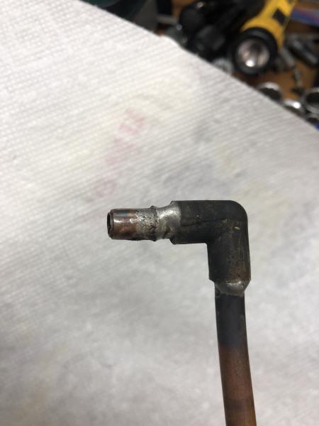

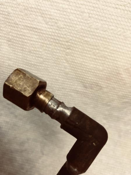

Or, you have a vacuum leak between the tank and pump. I just repaired such a leak. Bad solder connection.
