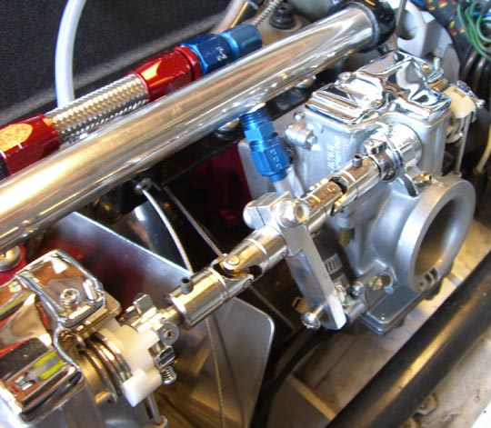

Greg,
Do you have a picture of your double u-joints? I'm curious about that setup.
Hi Paul,
Here is an “in progress” shot. I was waiting for a heim joint to finish the throttle cable. The double u-joint is actually 2 single u-joints. There is a shaft that links the 2 together. I separated them and did a little cutting to add the linkage arm in the center.
Greg,
What type of carbs are you running? Are they flat slides? Whete did you buy the U'Joints?
Thanks,
BOBH
I think that is absolutely beautiful. What a great piece of craftsmanship.
<div class="ubbcode-block"><div class="ubbcode-header">Quote:]Delortos? [/QUOTE]
Yes, please. May I have a side of salsa with mine?
Thanks everyone for the kind words. Sorry, I'm not trying to hijack Paul's great work. The carbs are Mikuni HSR 42s, and they have flat slides with accelerator pumps. The U-joints I picked up from McMaster-Carr. I had to turn the throttle shaft ends down to get them to fit the U-joints, I guess every application would be different.

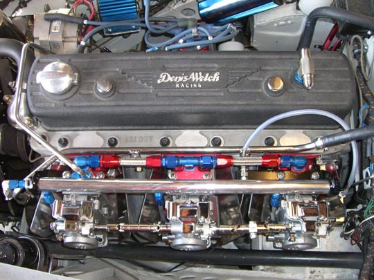

Hi Paul,
I haven’t forgotten you, we’ve been working very long days at work. Several of us thought today was Wednesday. Here is a wider shot of the engine. At this stage, I hadn’t finished plumbing the fuel line and the throttle cable had not been attached to the throttle shafts. The cable is the arc you see above the head on the right of the photo. Originally it was a SS braided brake line, Teflon coated.
Good luck with your throttle cable, I think you’ll like it.
