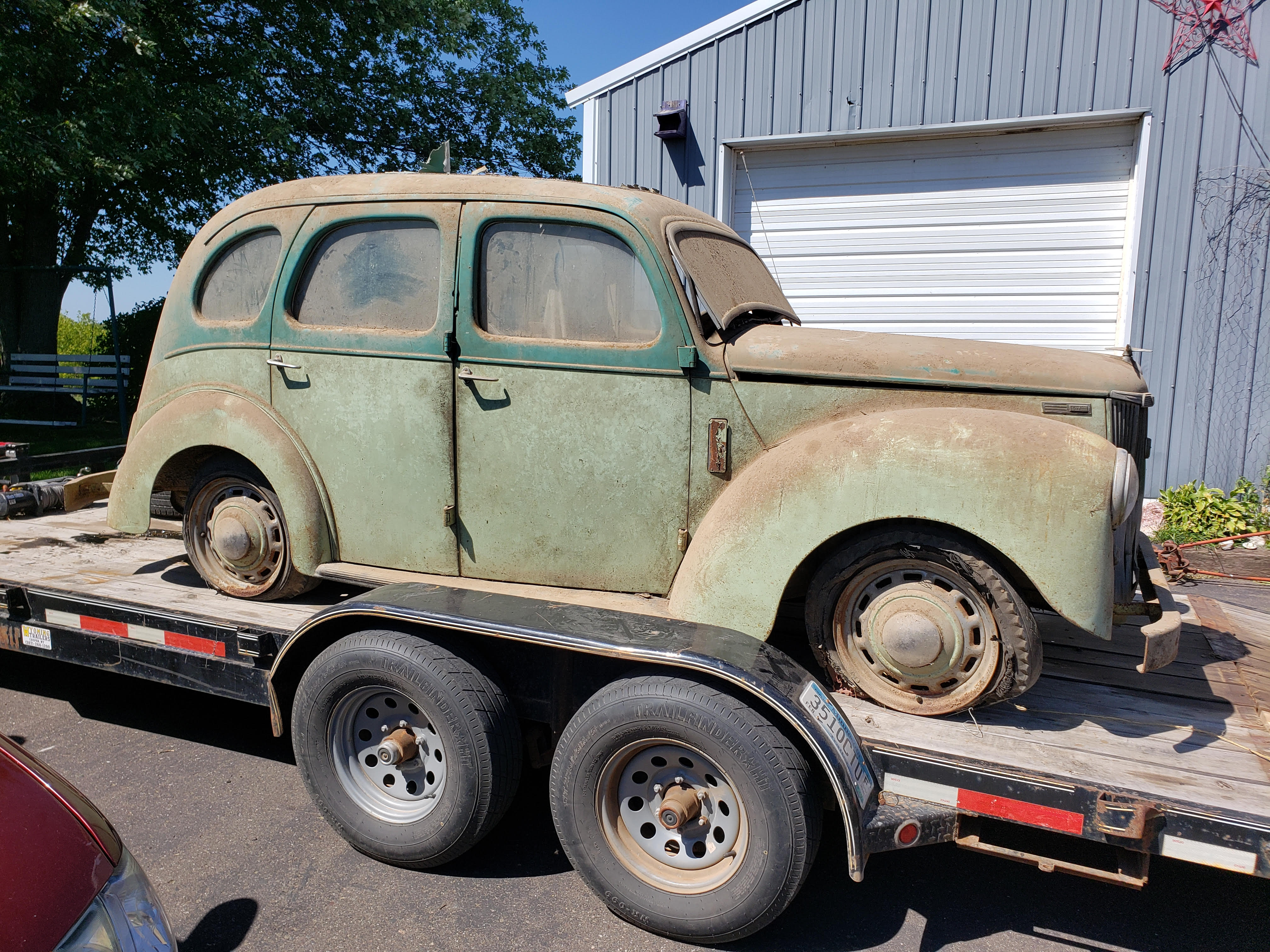

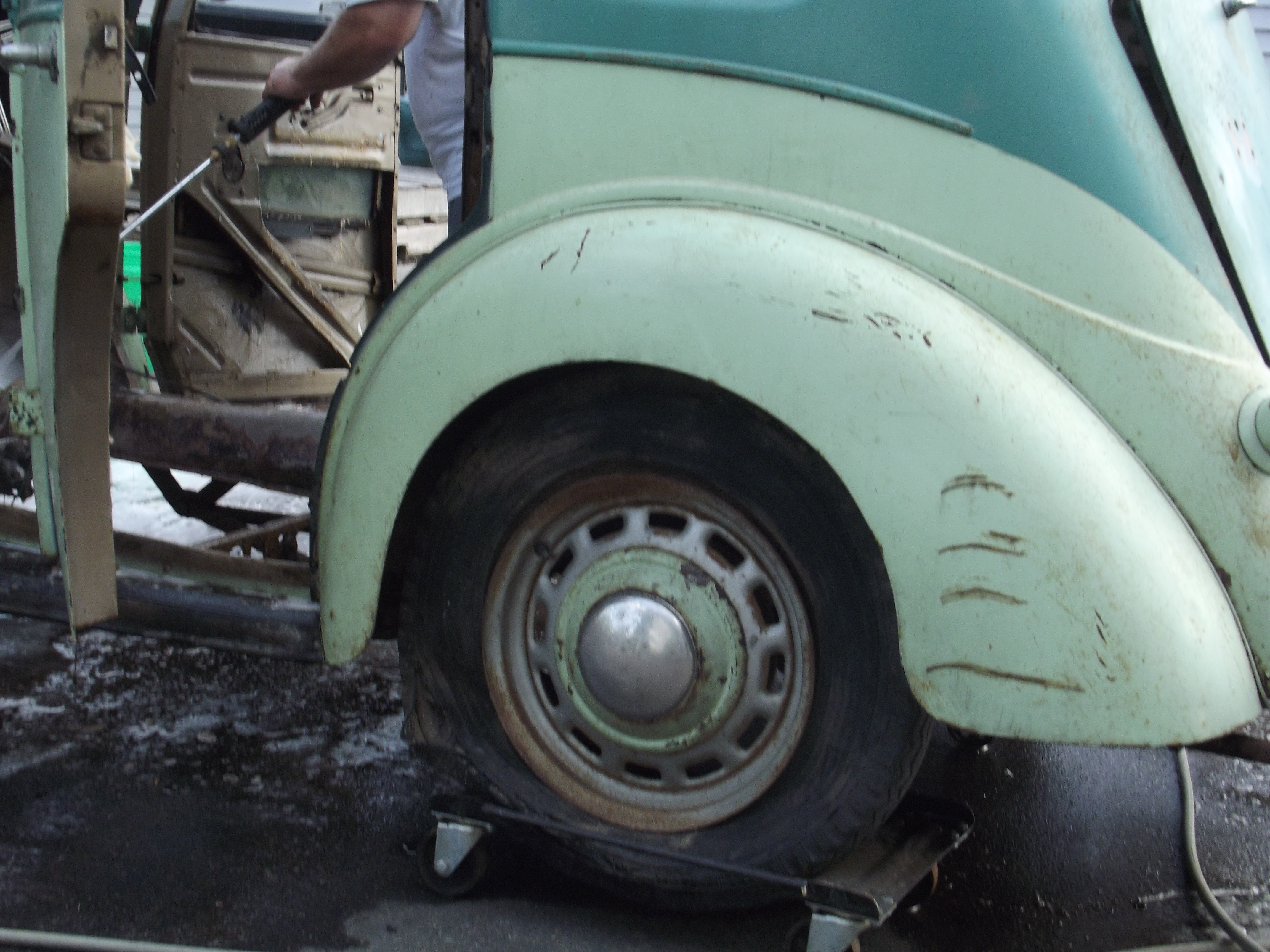

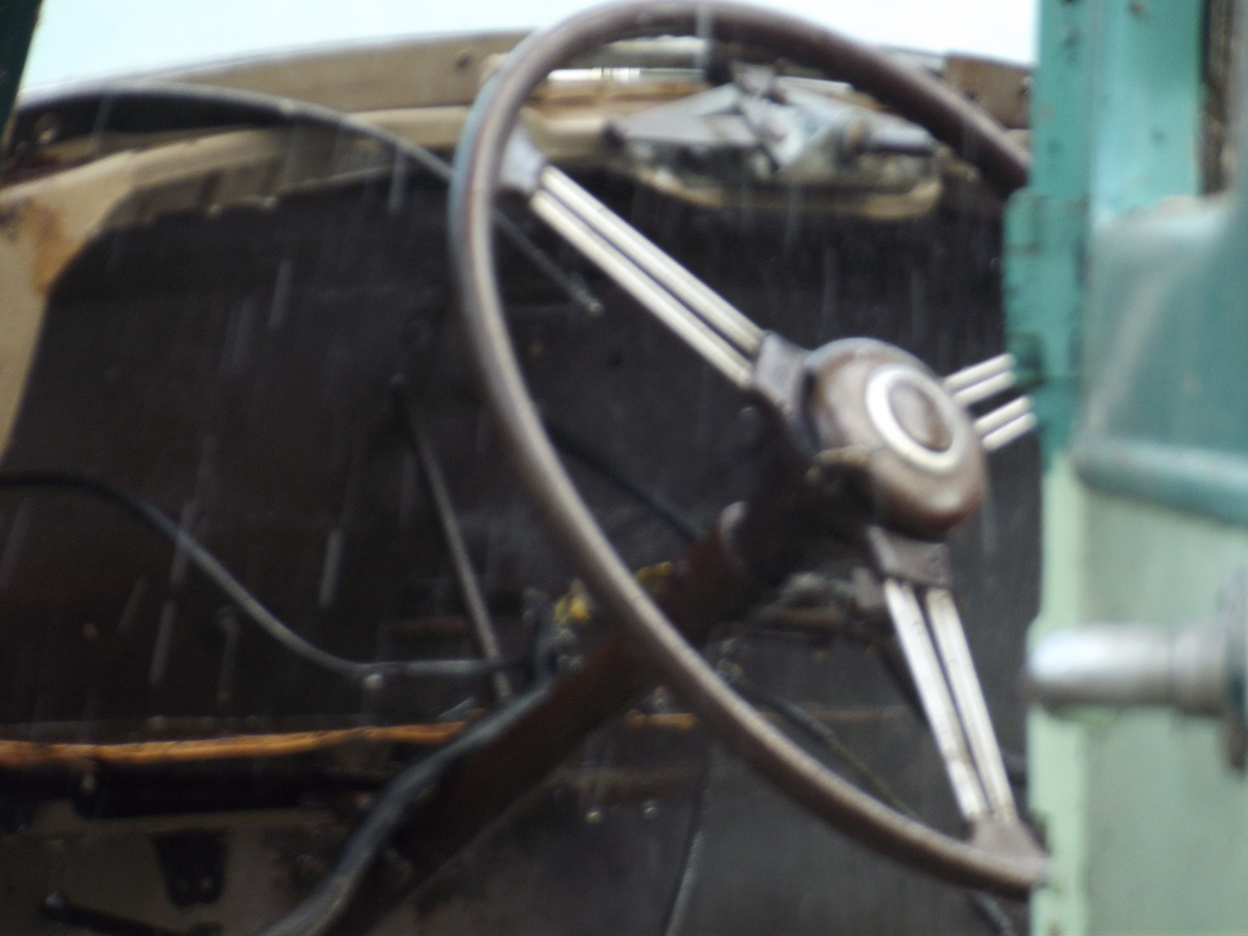

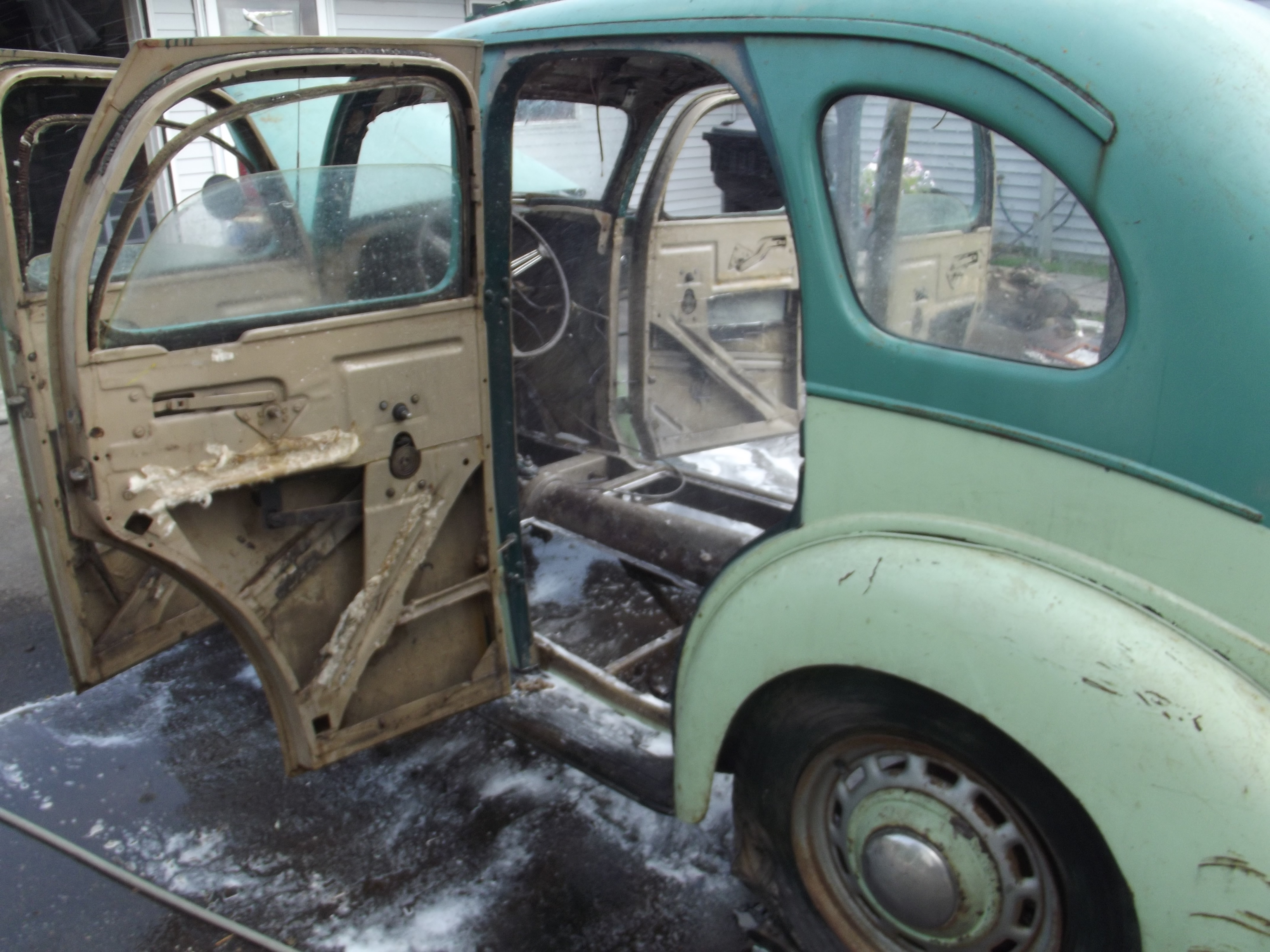

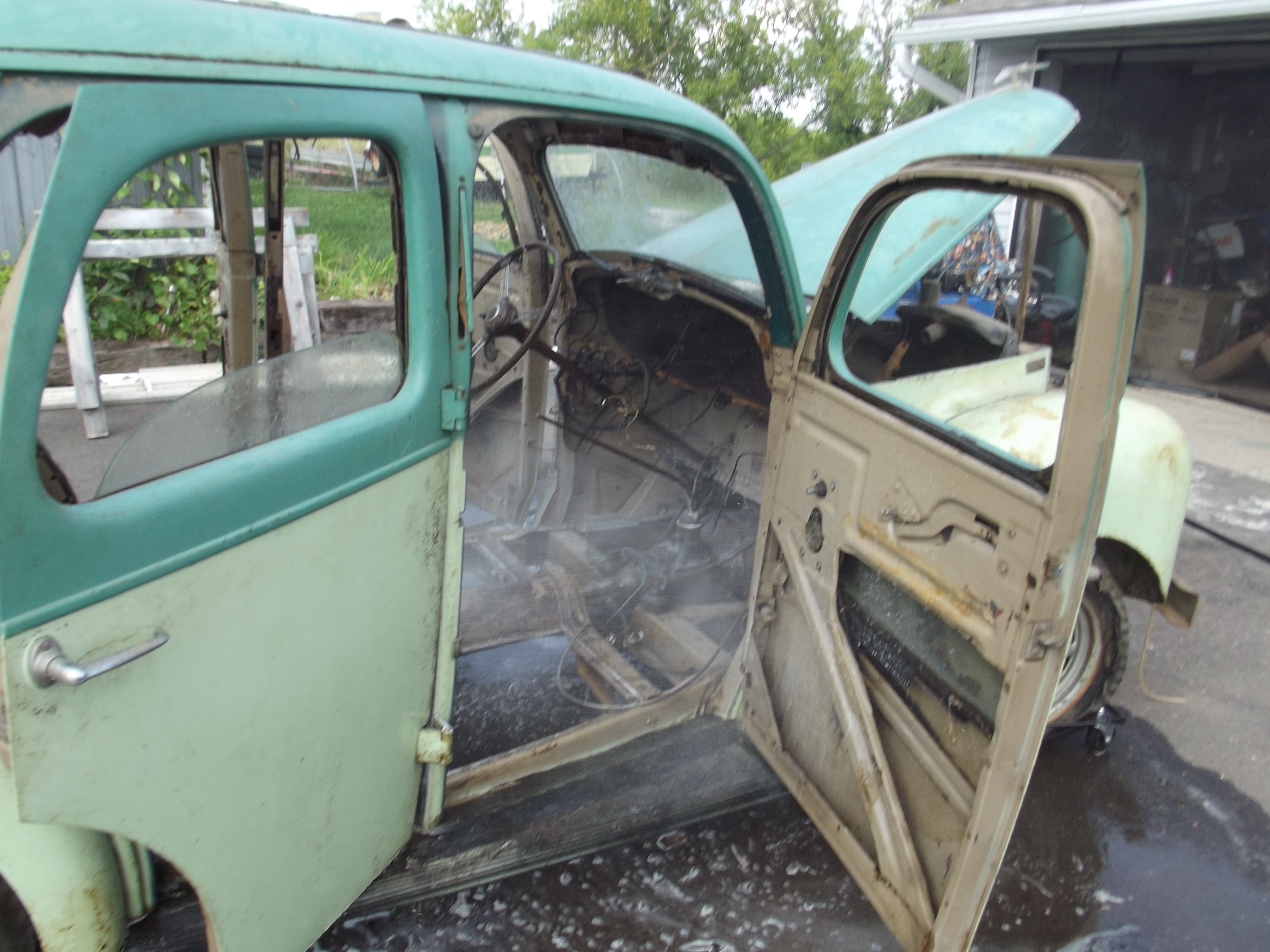

My engine has some kind of split valve guide and I do not have a machine shop that can do that. (I live in the middle of nowhere). I do have a press and making a jig is no big deal, what I am thinking of doing is removing the valve springs and just lap the valves by hand. Where the valve stem contacts the lifter it seems that the stem has an offset grind to turn the valve is that correct

I am at a disadvantage here in the USA with a side valve as no one has any specs on this engine and the machine shops that do engine work are about a 200 mile round trip and when asked all I get is never heard of it. I am going to remove the springs and hand lap the valves to clean them up and be happy. When I pulled the engine apart the mains looked good but the babbit was flaking on all the rods and again no one will touch one of these, I thought the Model T guy's might but nope so now I have to buy new rods, I passed on a nice Pinto 2000cc with very low miles and I kick myself although when doing an engine swap that will mean cutting and welding which I can do but I decided to go the way I thought was the simple way.
