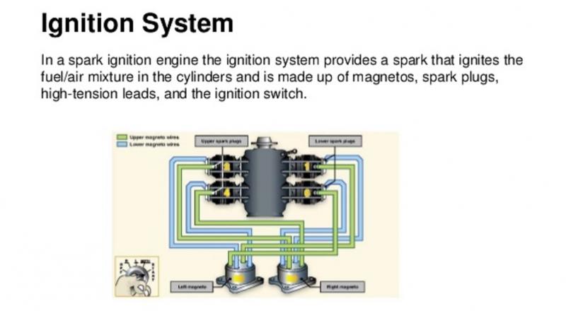

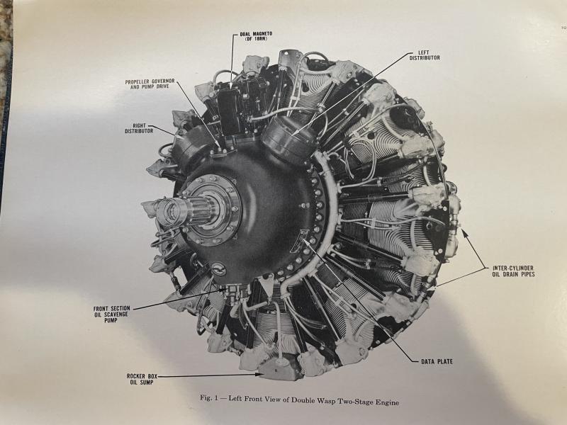

Interesting about the distributor nomenclature. "Left" and "right" as opposed to "front" and "rear"... does that mean the engine was further separated left and right for ignition? I'd have thought it would be better to fire all eight, each in one dizzy, front and back.
But what do I know. Just curious.
I gotta be missing something... P'raps both dizzys are firing all 18 cylinders, with dual plugs?
