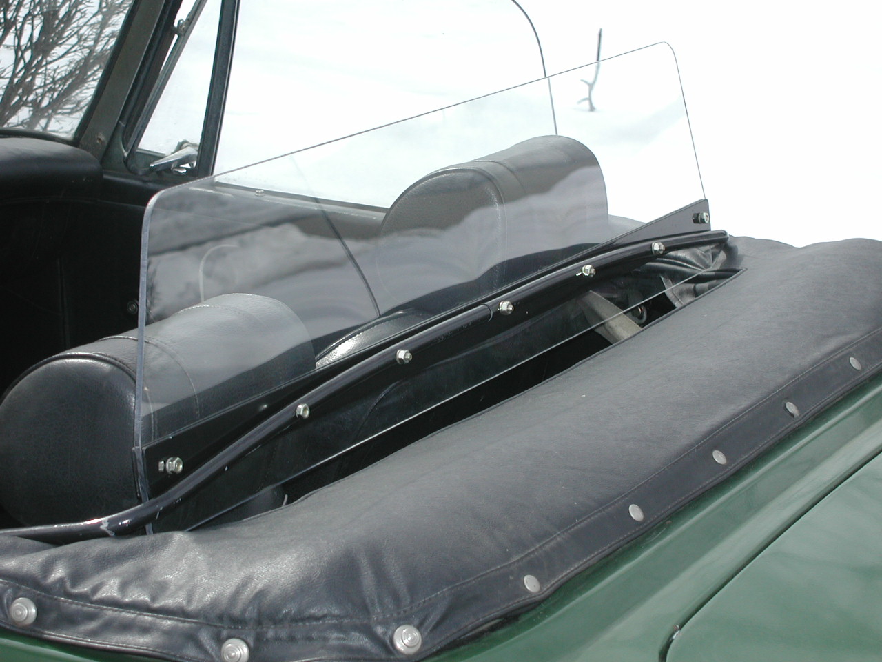

Wind deflector is simple to make. I found a MGB Tonneau bar and shortened it, drilled it and bolted a piece of Lexan to it for my own wind deflector. Worked fabulously in reducing cockpit turbulence. Top could go up and down with it in place and tonneau would fit under the bar. I missed the wind deflector as it would not fit when I put the roll bar into Bugsy. I added a pice of plexiglass attached to Bugsy's roll bar to accomplish the same.
Cockpit a lot less buffetting and lower wind noise and I can weara ball cap without worrying about it coming off on the expressway. Got pics I can send if anyone it interested.

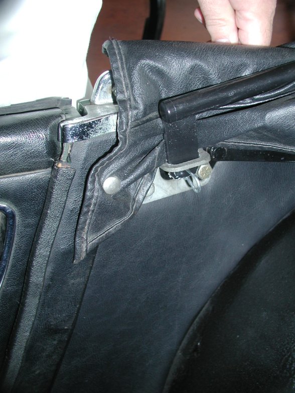

If someone could post a pic of what the tonneau bar even looks like installed, that would help me a lot! (and a closeup to how it fits onto the car)

Here are a couple of pics
and another
Thanks Trevor for Posting
Other details
This windblocker was made from an MGB Tonneau Bar that was narrowed / shortened 2”. Please note once installed there is a safety clip/pin that secures it in place so it is removable. Also the bar was notched just slightly so it would fit into the tonneau bar clip on the side of the cockpit. I added a backing plate of flat bar stock aluminum that the sandwiches the ¼” Lexan(not plexiglass) and I had to carefully drill the round tonneu bar so windblocker stayed completely straight. Much easier to do with flat bar stock if I was to do over again.
Procedure to remove/put up top.
Fold Seats forward
Pull Safety Pin on each side
Windblocker tilts forward
Top is raised
Side Bows clear windblocker
Windblocker tilts back
Safety clips pinned back in place
Seats returned to normal position
Windblocker can remain installed while top is up.
Neatly done, Trevor - & those look like Midget tonneau bars!
