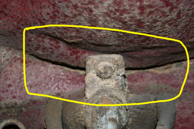

Maybe I'm wrong but this looks funky to me. Front right suspension on the 73. I'm particularly disturbed by the clearance between the shock and the body.
Fungy but clearance doesn't matter as both are hard bolted together.
Something beat the heck out of the engine bay from the other side by the looks of it. Maybe a massive supercharger on a crossflow head? /bcforum/images/%%GRAEMLIN_URL%%/smile.gif
Man that's nasty, haveing fun are we?
I Really wonder why this was done. I picked up a 73 GT a few months back and the exact same thing was evident. Someone clobbered the wheelwell and it sits right on the shock.

Lots of times its done so aftermarket headers/carb setups will fit....& since it doesn't hurt naything underneath, most folks don't worry about doing it....then we get to repair it!
