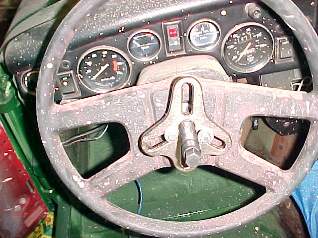

On my midget 1500 there are holes on each side of the bolt. That is where you attach the puller to. It has been 6 years since I took my wheel off for the first time, I can't remember if I had to thread them or not. When you use the puller just remember to grease the puller. I will try to enclose some pictures of how to set it up.

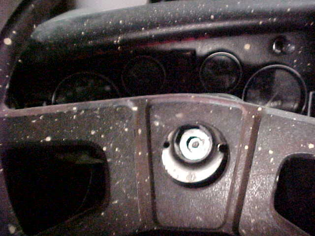

I have been thinking about it and I think I drilled and tapped the holes on the wheel, so you probably don't have them. It is easy material to drill and tap, and you can keep the stock wheel. I still think it is the cheapest way you can get the wheel off. I will attach a picture of the wheel with the two holes that I think I must have drilled. Like I said it has been over six years and can't really remember if I drilled them for sure, but think I did. I hope this helps. I remember beating my head trying to get the wheel off when my turn signal switch quit working.
Now, that last pic was a REAL help. I'll be drilling the hole in mine next week. Anything else I should know or that you may remember would be great...I know it's been six years.

I dont think I would drill holes in this type of wheel. I still say get the biggest guy you know and do it as previously suggested, believe me a big enough guy could probably pull the whole steering column out of that car.
That's the problem, a big guy could pull the column out and the steering wheel would still be stuck. Having said that, it could still break loose without a puller. Otherwise, I'm envisioning using a couple of lengths of angle iron and a generic puller. My fear of drilling and tapping the wheel is that it will stretch the metal and strip the threads.
I went outside and looked, I used the 1/4" bolts out of the puller set. Look at your tap set to figure out what size drill bit you should end up using to make the tap work. Someone may know on the forum.
