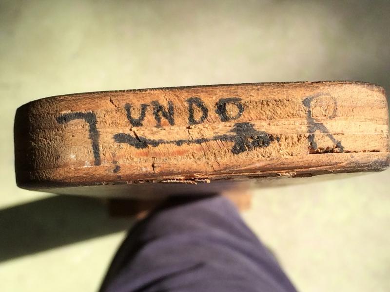

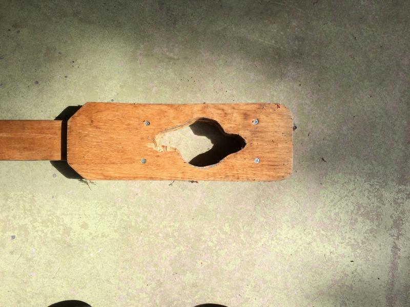

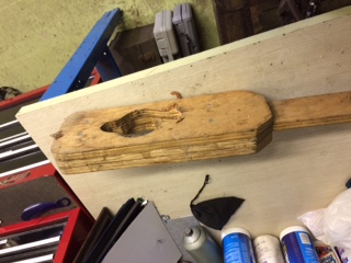

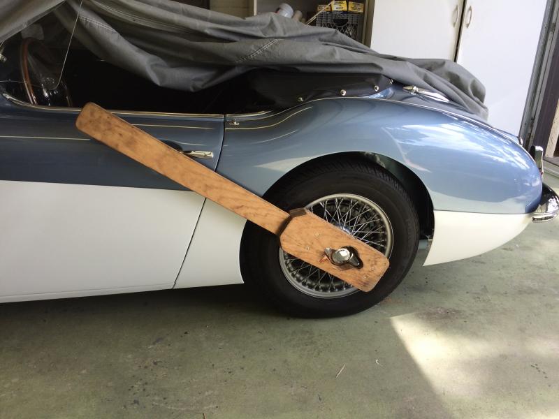

I've been wanting to add to this post but couldn't find the photos until today. Made this using 3/4" ply. Used 3 pieces of ply on the business end both glued and screwed. 43" long. Note the instructions on the end of handle to help me remember which way to turn. Haven't use the mallet since buying new knock offs 15 years ago.
That 3rd pic reminded me of something:
I have a cable with a swaged loop in the end and I roll the car next to a tree. The loop goes over the ear on the knock off needing tightening and I wrap the rest of the cable around the tree so when I pop the clutch in 1st ( it's the only time Iuse1st gear) right around the time it stalls I know it has hit the magic number Michael has found empirically. How do I know?I used to do it exactly the way he described, but my durometer broke a while back. Seriously though, I carry a copper hammer and some wood. If I'm home I might use a small 5 or 6 lb short sledge hammer and some wood. Wheel off ground until nut is snug, whack-a- whacka on the ground until snugger. So far so good.
