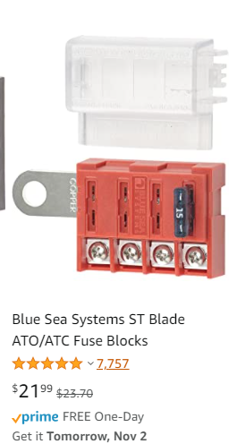

The reason I am posting here and not the Spridget forum is that I am wondering about the Solenoid. I have added I think 5 relays to the car (of the top of my head - one for each horn, high beam, low beam. driving light - So I have more power wires comning from the solenoid - which isn't a problem but it is unsightly. They all have inline fuses, but, is there a neater solution? Is there a Bus I could use or a separate fuse box? what have others tried?
thanks all
Bolted this unit directly to the Healey's solenoid as auxiliary fused-power for relayed driving lights, Low / High beams and an accessory.
Ooo that's what I'm thinking of - thanks, will have to see if it fits
