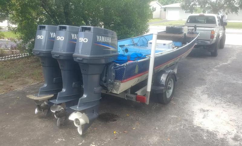

I call this Overboard Outboard
Overboard schmoverboard.
I call it "tail heavy".
harumph

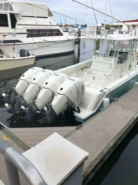

Don, i'll see your 270 hp and raise you 1,130 hp.
Boat seen at dock in Key West, FL. i can't impagin the need for that much motor on a boat that size.
Tried to make it bigger and failed.
Thats for when you want to get to that favorite fishing spot really fast!
