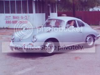

I tried it once in a Porsche 356sc engine that smoked and spit sparks out the tail pipes on a freshly rebuilt engine.
Now, that was no help at all. After tearing the engine down, I found broken rings on one of those pistons and the jug was shot from the scoring. Very expensive those were. And, no, I wasn't the one who rebuilt that one..just the new owner.
No, it was about 7 years old. I eventually had it repainted the original white and sold it a bit later. Can you believe I bought it for 1800 ? I don't remember what I sold it for but it wasn't much more.
