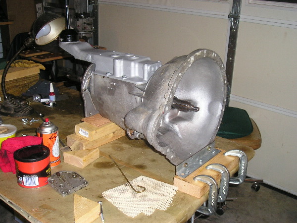

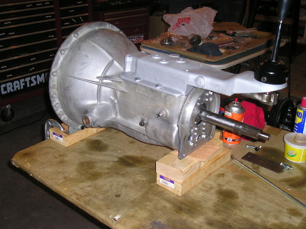

Today a friend and I did the finish assembly on the transmission. All the gears except the input shaft and its gear were already in the box. We turned the box upside down and fiddled the lay gears into position. We then spent the next 10 min wiggling the lay shaft and the main shaft trying to get the lay shaftt to slide in. we could it in about 2 inches worth and it would stop. we kept jiggling and fiddling and all of a sudden, bummff and it was in, ready for the wedge lock plate.
I put the top cover on to check the operation and it seems to work fine.
Now it's mating the OD to the gearbox and then on to oil filling and testing.
One more step towards completion! Yea!

Nice job.
Very smart to bolt to bench. I've seen grown men cry when weeks of work and waiting for parts have ended with a completed case rolling off a bench and hitting the floor.

Paul that thought crossed my mind as I was working on the OD, so it followed with the gear box. I definatly did/do not want to test its integrity by bouncing it off the floor!

I see the thick flange and the raised bosses all around your bell-housing. That tells me it's from a TR which is later than your 1960 TR3A, so I assume it may have synchro in all 4 gears.
On the LHS of the gearbox, I can see the oil fill plug. But what is the other one for, or is that something on the later cars that was not on the TR3A gearboxes ?
The raised, cylindrical bulge behind the fill plug is another sure sign that it's a later box with synchro on 1st. 1st gear is a slightly taller ratio, too.
<div class="ubbcode-block"><div class="ubbcode-header">Quote:]On the LHS of the gearbox, I can see the oil fill plug. But what is the other one for, or is that something on the later cars that was not on the TR3A gearboxes ? [/QUOTE]It's where the pivot for reverse gear sticks through the case. Not found on the earlier crash boxes, which used a sliding fork instead of the pivot.
