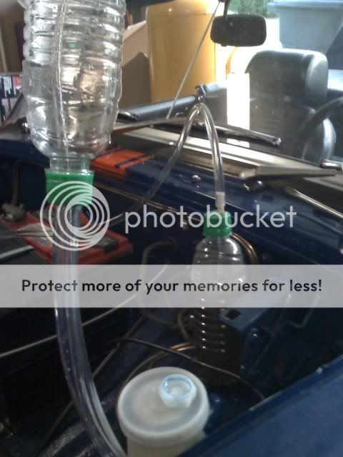

The only problem I had with inverting a bottle into the res, was control of excess spills and finding a bottle small enough to fit into the opening of the clutch res. This filler I made cost all of .54 cents, and there is no spillage problems, and it keeps it at 3/4 level constantly.
Works for me, just thought I'd share.

Here is the set up, notice the "Valve" placement and vertical position:

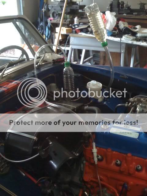

In progress:

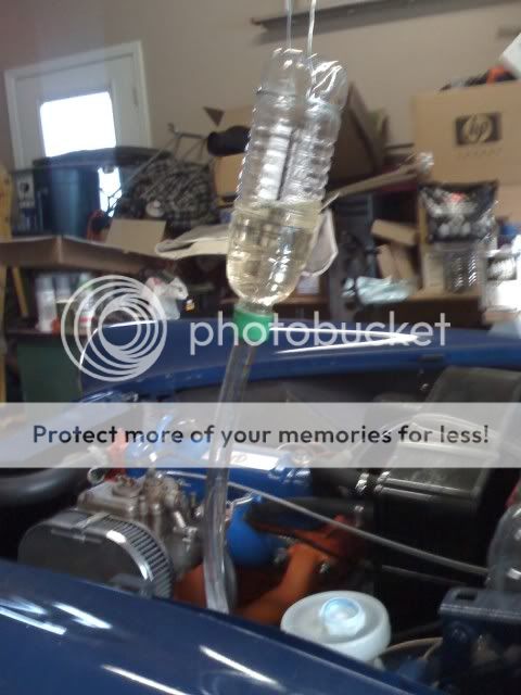

Finished running 12 fluid oz through the clutch slave cylinder. Notice the catch bottle... ewwwwwww And that was after I ran clean fluid through this!
All in all this was very quick, 15 minutes tops start to finish!
The brake fluid did not affect the "Valve" it worked perfectly after sitting for 4 days with fluid in it.
