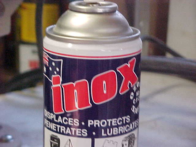

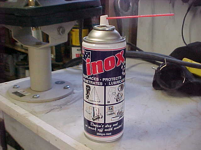

doc, try this, does everything and its great on salid.
Italian
You should know better
Cheers
Mark
