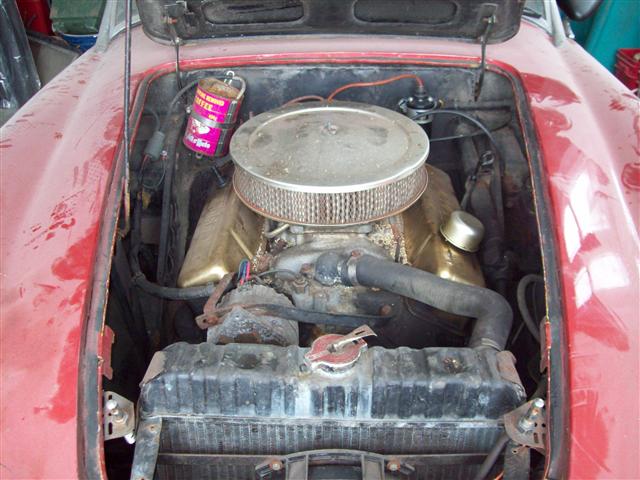

I used ATF and acetone, 50/50 mix today as I had 350 V8 Chevy engine locked solid in my Nasty Boy Healey.Pry bars on the flywheel would budge this locked motor.Car had not run since about 1983 today a bunch of this weasel [censored] down the bores under pressure helped unlock the sleeping beast.By four we had it up and running with some gas down the carb.
Cheers
Mark
The coffee can was the optional windshield washer bottle
