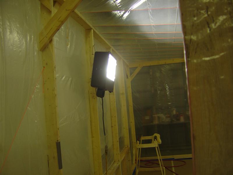

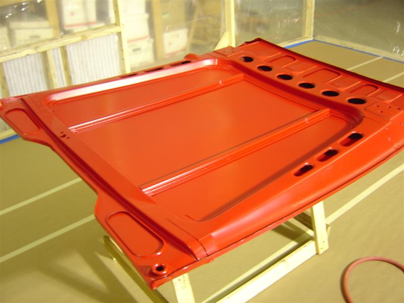

Ok Brosky
here are 2 pics, one of the light I am using, the kind that lights up parking lots, and one of the base coat on the hood, the pic after the clear coat for some reason was really blurry, looks like I need a new camera, seems a lot of pics are comming out blurry
Hondo
hondo402000
hondo402000
the light.. the booth is working out fine, the fan really clears the booth good too.

Brosky
Looks good. Make sure that your setting didn't go to macro or off auto focus.

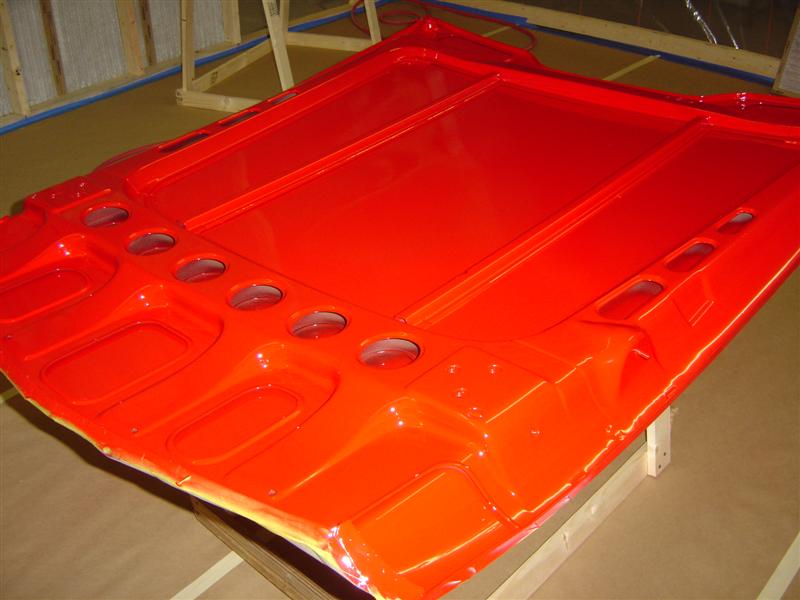

Pic of Bonnet underside with clear and overnight cure. It might be next weekend before I can paint the top side, finders and boot, still getting the doors right,
HOndo

Brosky
Look at the paint coverage in the holes and slots in the hood from all angles. If you don't get a full spray in there, you will see the primer color when the hood is open.
I'm sure that you've guessed how I know that to be true.
dklawson
Brosky, is that an area that can be hit with a touch-up gun or an air brush? On my projects I'll often use an air brush to put down a "pre coat" in tricky areas like that and on seams and edges.
trrdster2000
Hondo, don't try to get in there with a wide spray. Cut it down to a needle, reduce pressure and walk around in a circle for each hole. If you can get to it now before the paint is fully cured you could only have to mist a clear coat over that area, then buff it out when all cures.

Brosky
My will be done with an airbrush in the spring. I never noticed it and neither did the paint shop, but when the hood is up, the polished stainless radiator shroud shows a few that have "dark circles" inside. With a stock black shroud, I never would have seen it.

Wayne,Pware and Jim, I actually live in the south park area, but my office is in indian trail, thats where the painting is being done. I looked at the holes and I seem to have gotten good coverage in the holes. I was thinking of actually getting some board like what the radiator shroud is made of or simular, cutting out pieces to match the holes and gluing them in. Guys check your pm

Tom74TR6
That was the hardest part for me to paint. Watch for runs when spraying inside the cavities. It is impossible to sand anything on the inside of those holes. I will end up covering the holes and center sections with some sort of decorative cover.
