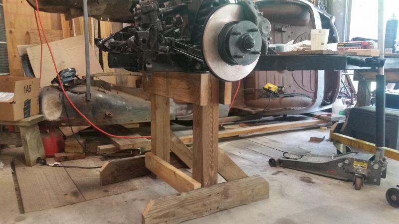

Looking around the shop I found that I had material to hand to make my stands. Some of boards were saved from our deck. Recycled wood.
Very solid and only took a couple of hours to make.
